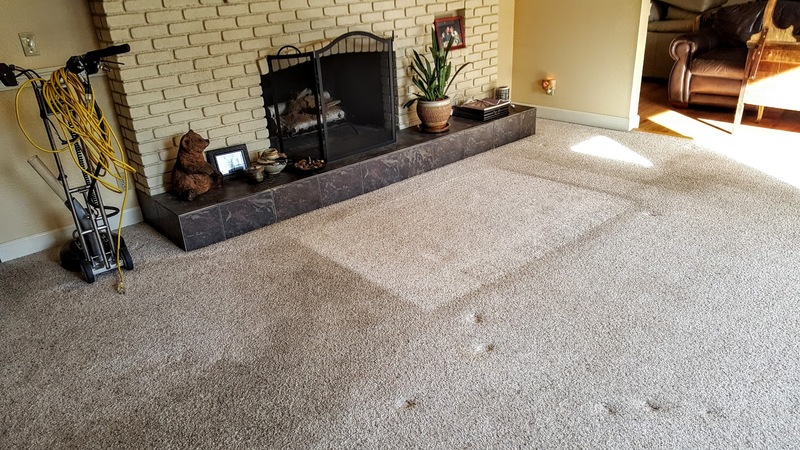

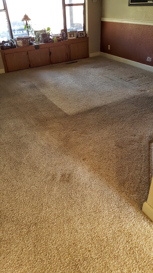

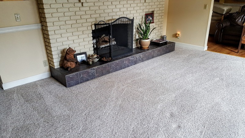

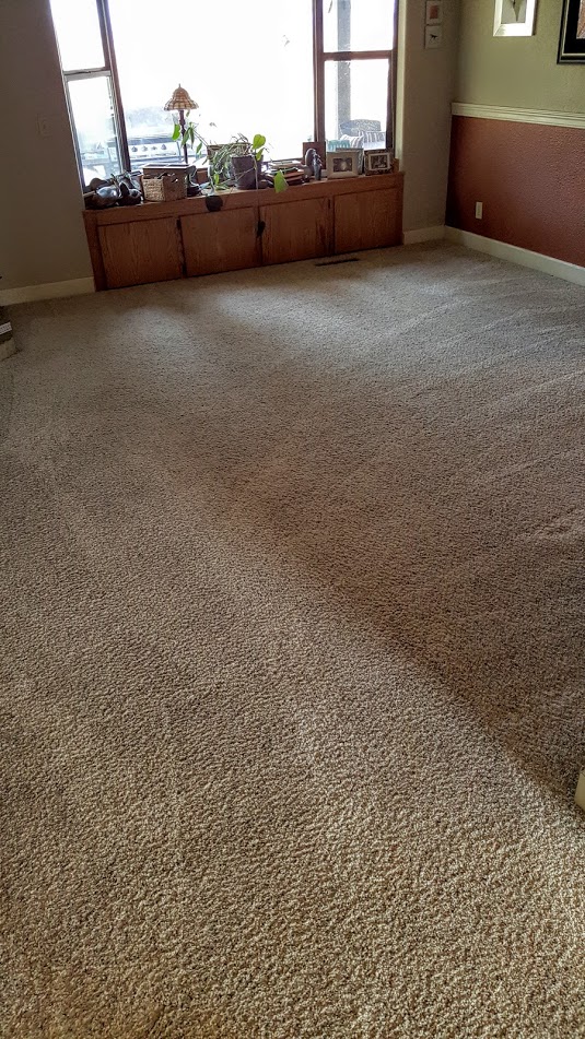

DYS for the last ten years...House is up for sale and the agent said hire a pro this time..
I was tempted to grab a Nuke It prespray but wanted to see what Procyon could do..
Two ounces per gallon of OG Procyon.
RV360i w/ BrushHead
Mach 12 trim.

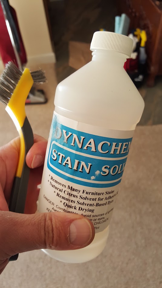

I forgot my Rust Remover and low and behold, Larry Carb to the rescue!

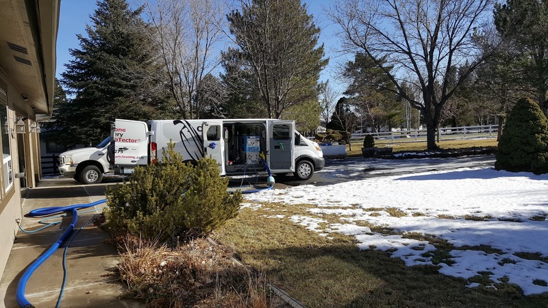

Heck of a day to be out cleaning..

Wow...that Procyon is some good stuff? Nice work! What rinse do you use with that?

Procyon doesn't require a rinse agent.

No need for a high pH bullet on a residue job
Lube it up and power rinse.
Owner filled his OG Dyson three times.
I hit it with the Royal one more time and I still loaded up the Devestator with crud.
The RE was key here.
Flush
Flush
flush.
