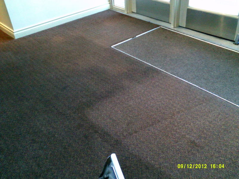

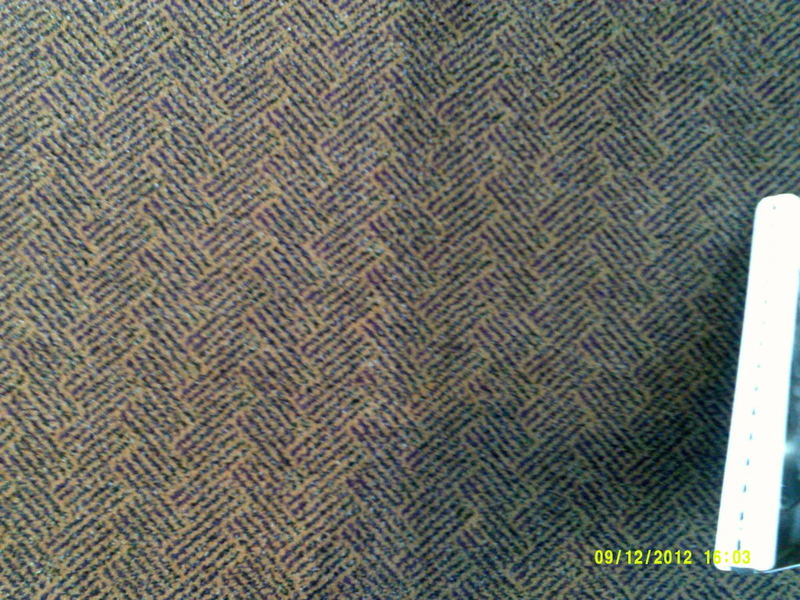

Hmmmmm - This was cleaned with NO prespray and 5 ounces of SS rinse to 15 gallons in a porty.350 psi (I took those pic's to tick off Lee - a spray and clear water dude.) Now envision the added ability of that cleaning punch WITH a good prespray and agitation and a good rinse solution. Now think about your recovery rate. How much detergent is left in the carpet? a very minr amount and if it;s a powder.... Red herring?

Hmmmmm - This was cleaned with NO prespray and 5 ounces of SS rinse to 15 gallons in a porty.350 psi (I took those pic's to tick off Lee Stockwell- a spray and clear water dude.) Now envision the added ability of that cleaning punch WITH a good prespray and agitation and a good rinse solution. Now think about your recovery rate. How much detergent is left in the carpet? a very minr amount and if it;s a powder.... Red herring?
Ooops - Forgot the pic
NO PRESPRAY JUST DETERGENT IN MY FRESH WATER

Sooo- How much dirt are you leaving behind by NOT using detergent in your rinse?
Granted the detergents in your "rinse" were better than your prespray from the pictures.
I started doing clear rinse after a Monsanto engineer told us their preferences.
Willy, after you finally get it clean how much chemical is left behind?
The carpet had no prespray on it all. It was bone dry.
A realistic recovery rate of 75 - 85% depending on the fiber, a powdered product that comes of with vacuming - not much. But look at the difference in the carpet. Hard to deny that- again just water with detergent, 300 psi - BUT- when used in conjunction with an effective prespray the end result has to be improved soil removal. I like arguing with ya Lee (especially when I'm right) Reminds of the old red board days.
