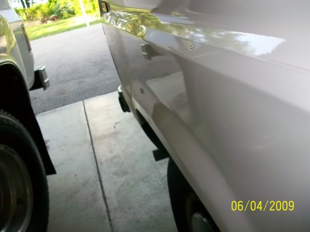

were you around when i showed everbody how to rivet
quarter panels on....
i'm thinking this was the second..maybe third set of quarters that i put on this truck...
you can make a truck last almost forever..

Thats pretty slick! My backup van is looking rough but I don't want to put a lot into it, you got any more pics on how you rivet panels on?

i did have a bunch....but im downsizin my photobucket..
it's soooo easy...
basically you jus hold the repair panel up to the truck and trim off anything on the truck that gets in the way.....
the repair panel should come cut to fit the body line.....
BUT..don't forget to prime the backside real good...or it will rust out in a year
each side should take an hour or so..easy peesy
i paid $600 for that truck in 1996 and sold it to CRASH when i sold my business in 09....
and that's all with the SAME Genie in it!
you know in Cuba...they use cars forever!
