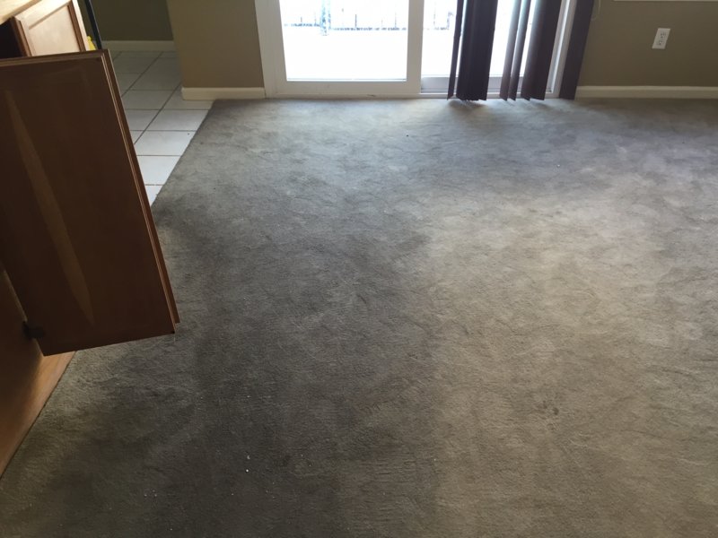

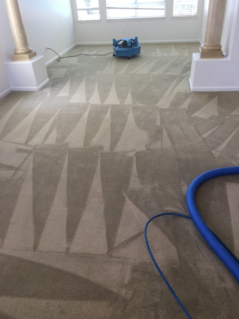

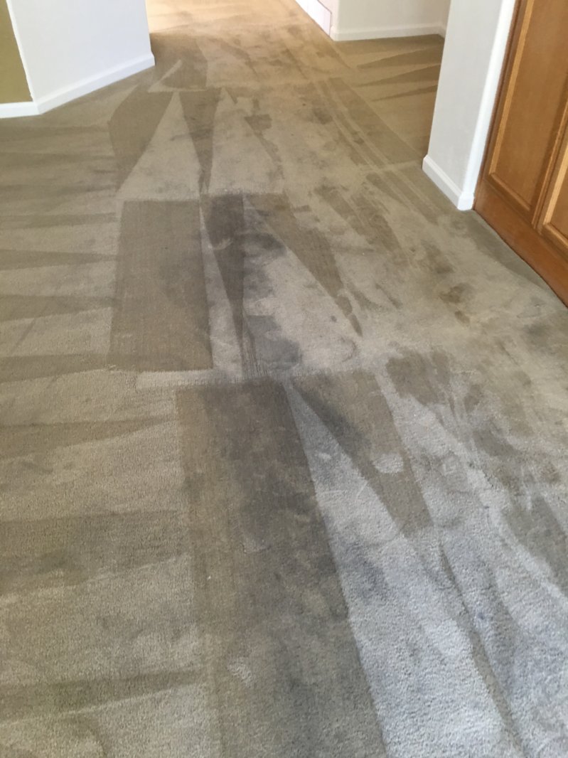

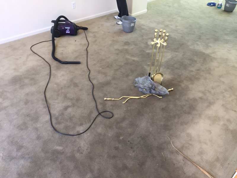

Son gave bid to property manager! Told them to replace carpets! But if we cleaned it $350.
They hit it with 8 scoops power max boosted with oxy blaster, rinsed with liquid 90
10 crb 8 flow wand.
Jeremy : "Dad not even a rotary would help that carpet".
Got a call from property manager I now it needs replacing, but I've seen you work miracles before. He was hoping for better results.

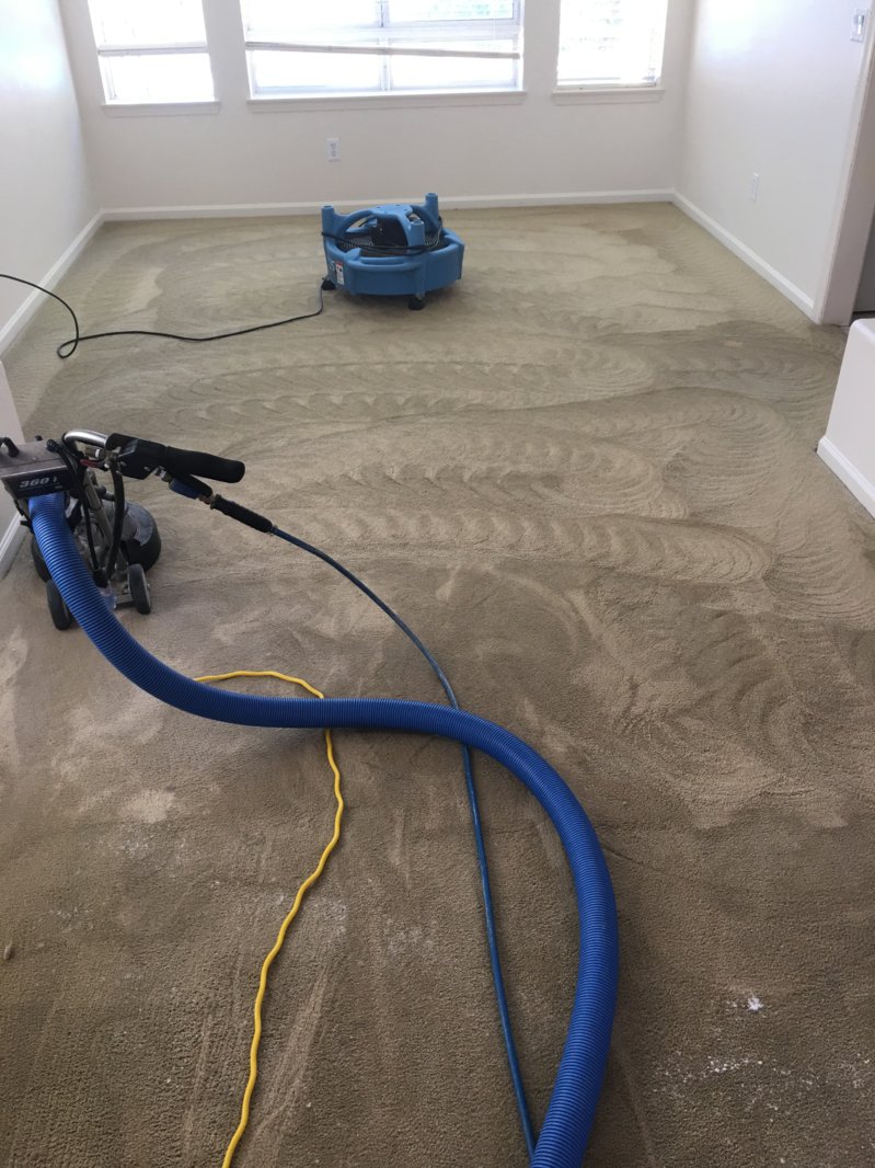

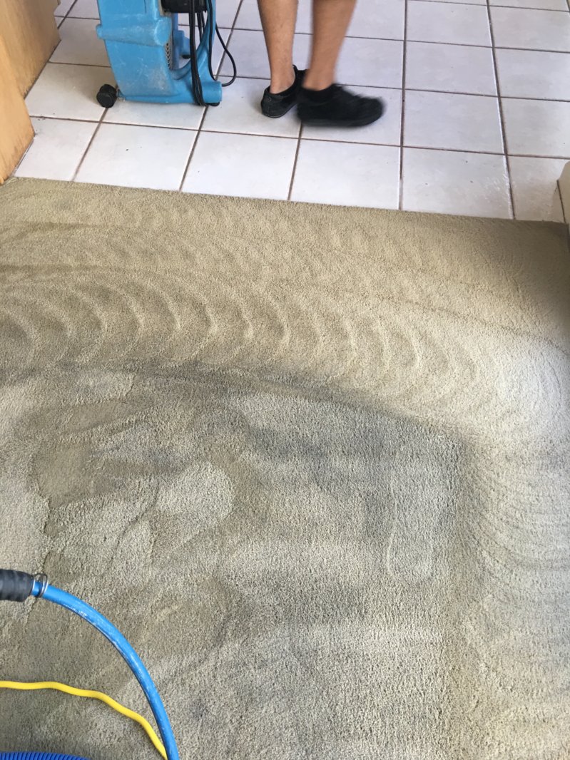

So I went back and tried again.

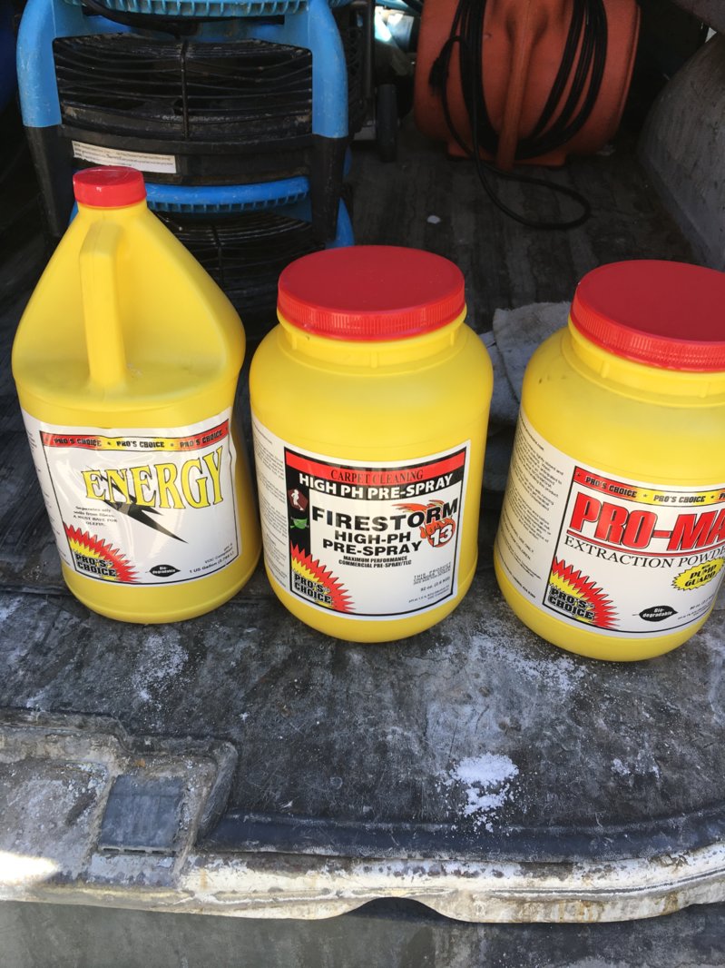

Bought some Firestorm, Energy, and Pro Max extraction powder.

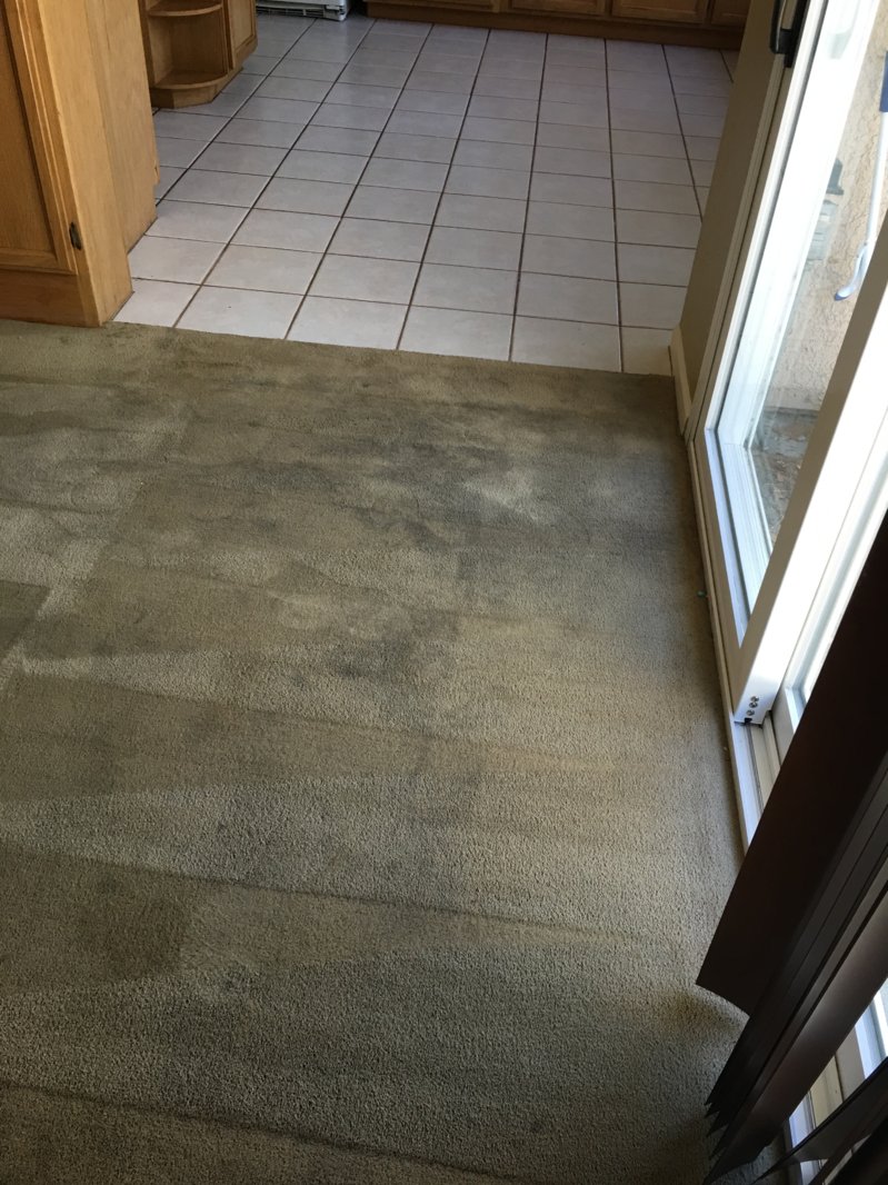

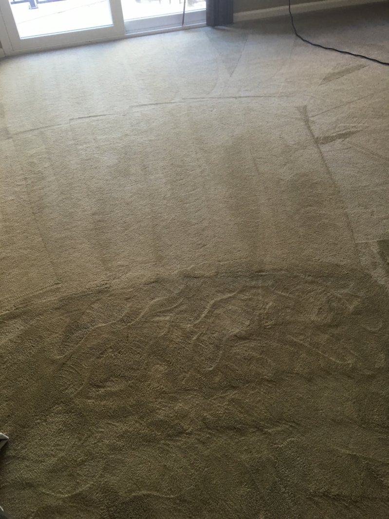

Pre sprayed firestorm boosted with energy and boosted the rinse with energy and broke out the 360i.
Hopefully they can rent it!
I deserve a raise.
Not perfect but better.
