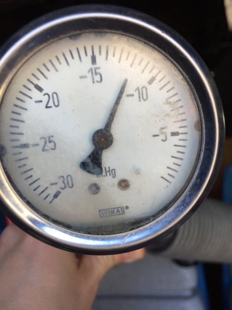

This one is for Mikey . . . since he is only @13" hg. on his Sapphire TM.
Test read 16.72" hg. ; highest we have seen in a dual cord portable.
Of course it does drop when cleaning carpet, but we still read 9" hg. at the wand while making a pass yesterday.

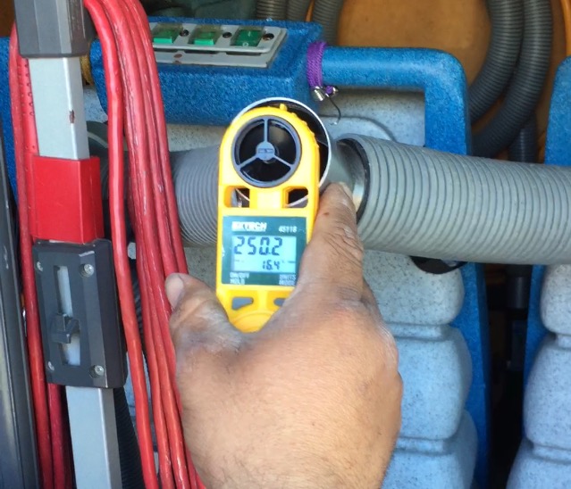

Alrighty .. I took my dual Galaxys and ran a foot long 2in vac hose with a 1.5in reducer to the inlet and the 2in end to a 2in all around Y and I end up with 12hg which is 163in of lift along with 250cfms. One of these porties is about 8-9 years old with the original vac motors that wee n whine when you shut it off. I wonder if I drilled out for a 2in inlet and new vac motors if Id get more lift n cfms.

Haha .. thats not my hand .. thats the guy at the supply shop. I couldnt afford my own anemometer .. so I took it in and had him check it !! Hes the mechanic there !!

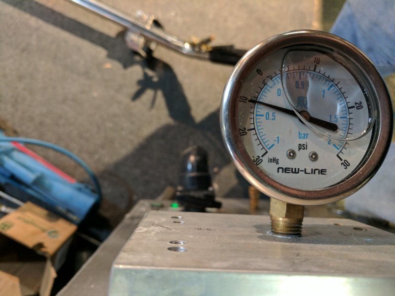

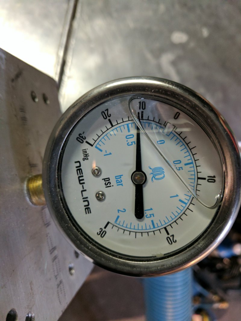

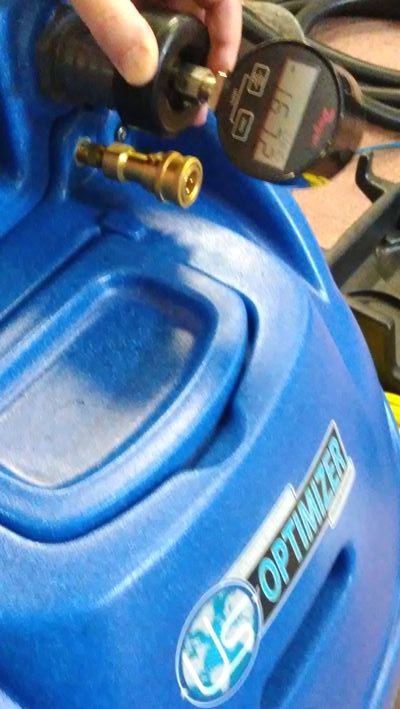

If you had enough airflow, your suction wouldn't drop. Here are 3 pics of my portable. One tested at the machine, with 50 ft of 2 inch hose, with 100 ft of 2 inch hose. No drop in suction. Between 10-11 inches hg.

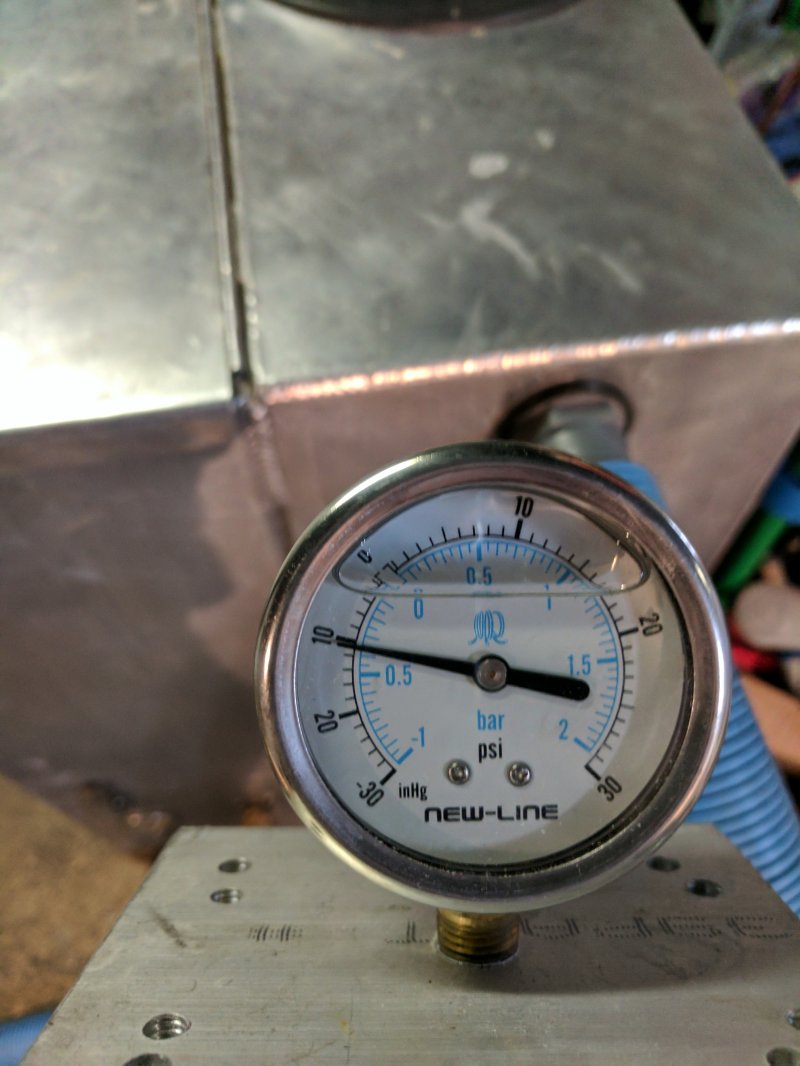

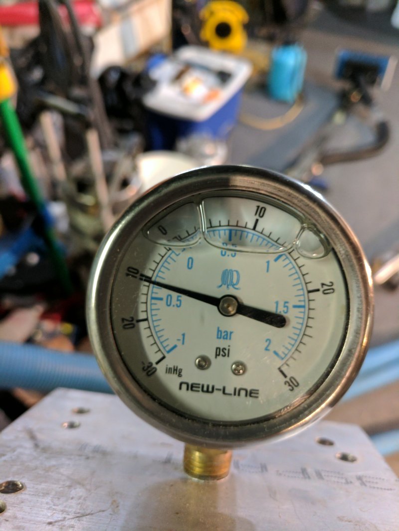

I just threw another 50 ft on. So here's 150 ft of 2 inch hose pulling 10-11 inches hg. On a portable pulling under 30 amps on 2 power cords.
