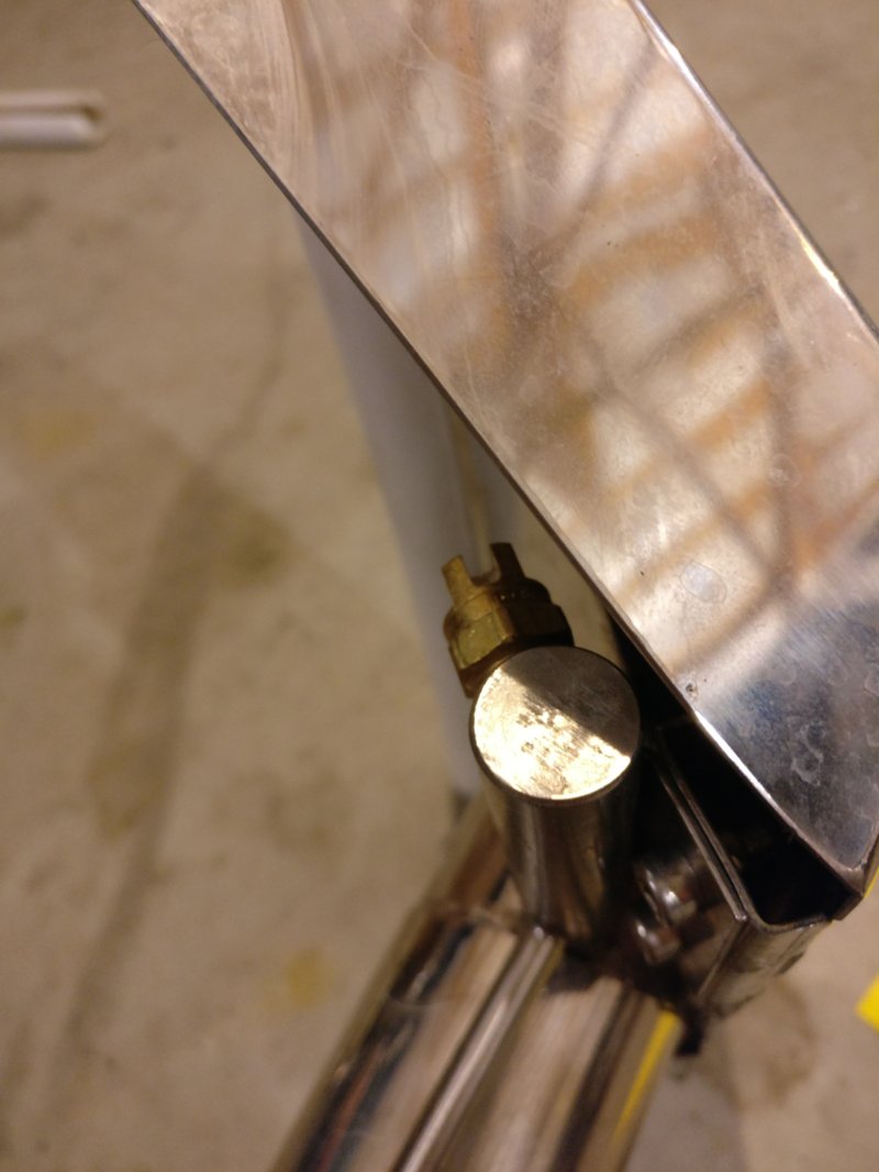

I bought a new TM. I got a wand with a green glide. Not a fancy wand but good enough for an employee..
Issue with wand:
The chemical meter will not adjust at all with this wand. I have tried. Different jets, different quick connect. Also, taking everything apart to make sure no trash was in the line.
So, they sent me another wand the same one. Same issue. Changed jets and all.
All of my other 9 Wands and tools adjust with no issues. I tried these new wands on 3 different tms.
The dealer is going to send me a reducer to put in my TM to help it pull chemical. But, I just don't understand why this would have to be done.
Any suggestions?

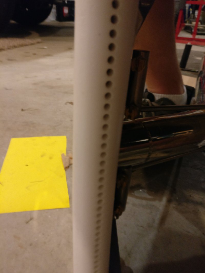

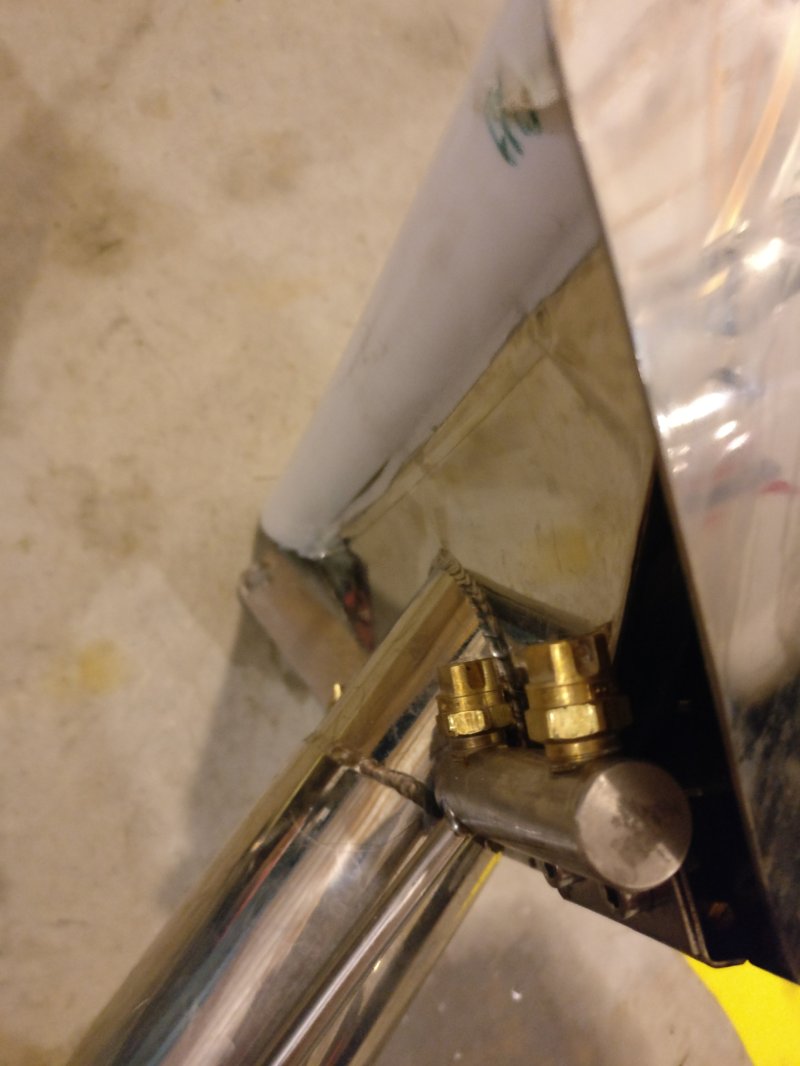

Also, I know the jets need to slightly graze the glide when they spray. But this particular wand sprays behind the glide. Never spraying on the actual carpet at all.
Its kind of hard to see in the pics what I'm talking about on the glide.

Looks like it was not built with a glide in mind. From the picture it seems like it will hit in the right spot if it did not have a glide.
Unless you can adjust the jet angle or work without a glide, I don't see how it would work.
On the positive side, it sure looks like it will keep the back of the glide real clean :winky:
It looks like the manifold is aimed to just graze the wand with no glide. Add the glide and it sticks out more.
With the hard line it doesn't look adjustable without slightly bending the line and mounting tabs. I agree with Mike - don't waste too much time on this wand....

Don't get ANY wand without adjustable jets. When the spray hits the glide ... you have a problem.
Not worth it.
Most people never change the jets angles. And some of the mechanisms out there that allow you to do it, don't work that well either.
How many people here will actually change the angle? (Past the first week that they got it, once the novelty wears out).
Just get a good everyday wand that will do the job and don't over think it. However, a good wand just like a carpet cleaning machine, is one of the best investments and return on your money you can make.
