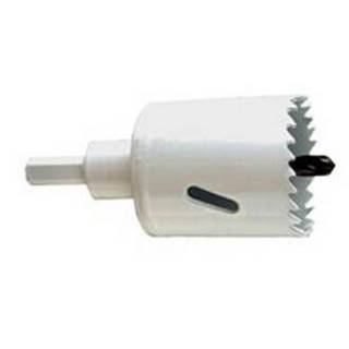

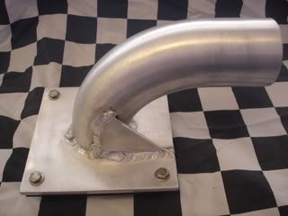

Marty put one of these elbows on your tank and let that 2.5" hose breath, you'll have a Mini-V.
Then buy one of these in 2.5" for your hand drill, even a pig farmer can install it.
