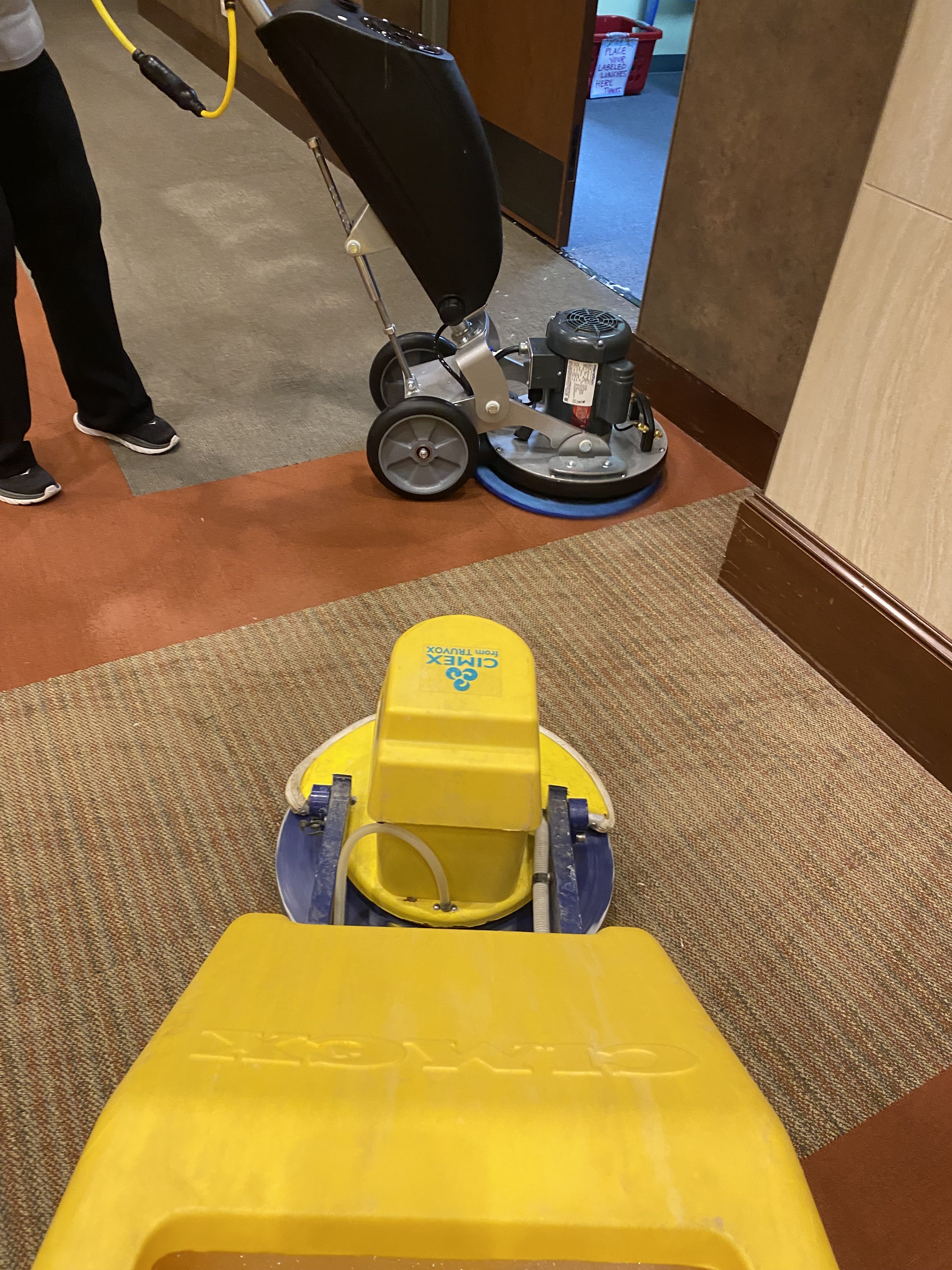

Instead of a Cimex I now have a 20'' Whittaker Trio that I use to scrub first and follow with Phoenix and bonnet. I don't do it that way on every job. Sometimes I will use a fiber pad on Phoenix instead of Trio.
Trio is definitely VERY LOW MOISTURE cleaning. It puts down a fine mist in front of 3 brushes with 75 pounds sitting on top of the 3 brushes. 15-30 minute dry times. It's a excellent scrubber

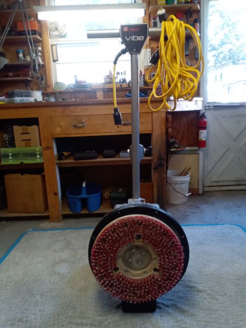

My first OP was a SprayBorg. I bought it when I first started experimenting with VLM 15 years ago and still have it
And I have a Tankless Vibe that I use on big residential so I know Orbot makes a nice OP
I bought that malish driver in 2015 for the SparyBorg. It makes SprayBorg/Vibe much more aggressive and digs deeper on residential carpet. Hated the velcro driver

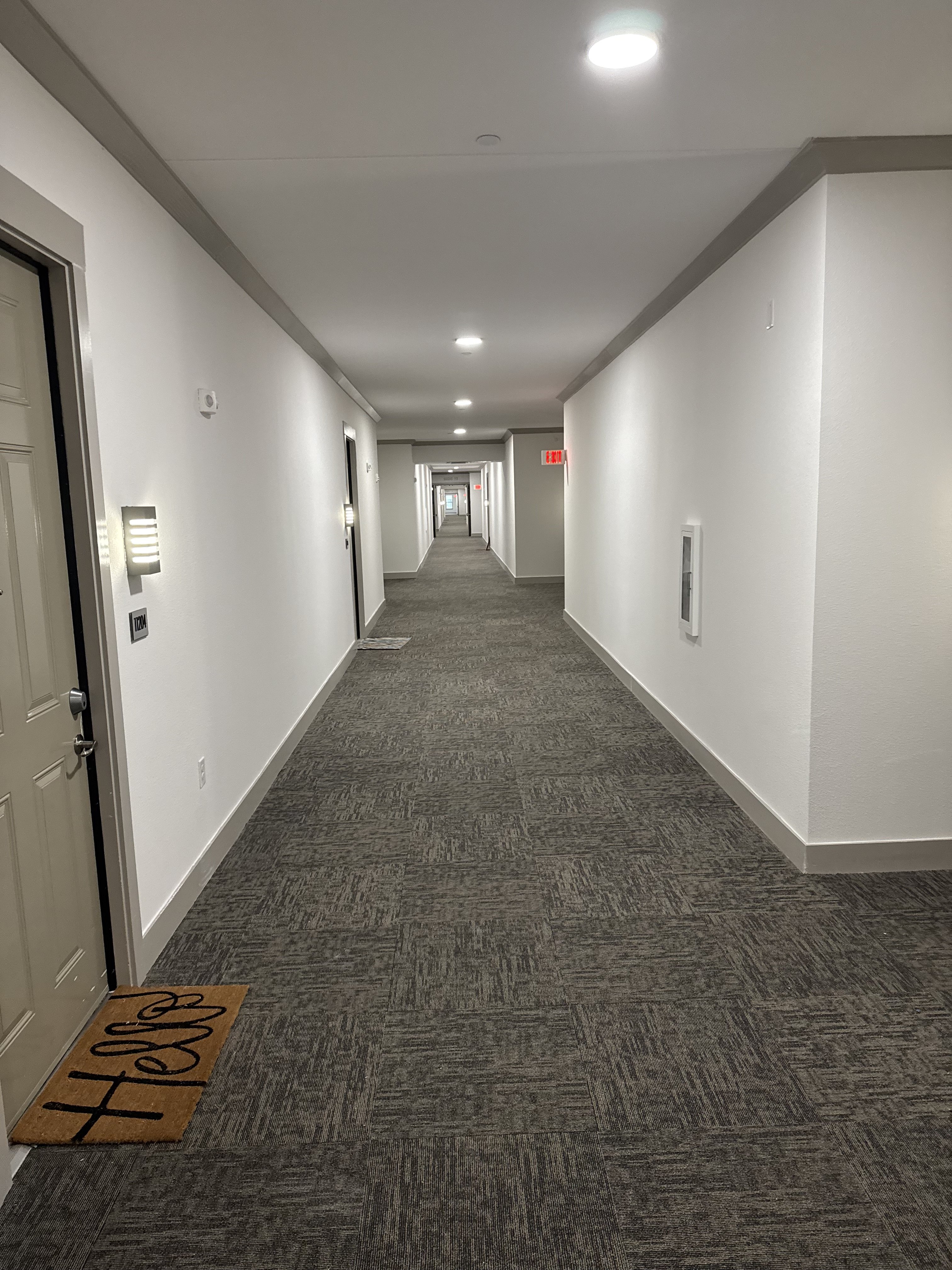

Well thanks to the advice and encouragement I got here I am moving forward with expanding my biz into VLM. Or is it LM? They want to to start asap and I am going to buy a used Orbot Vibe locally. I may have ordered a new Sprayborg but they appear to be 4-6 weeks out or more. Going to make a few calls in the am to verify. For those of you who do large cgd jobs I have 2 questions.
What pad ( bonnet) and size would you use for this cgd? (Link to purchase?) And how many would you use per day on 1 machine?

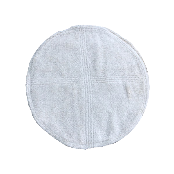

If there are worse areas you'll want to pre scrub it when a brown 3M Fiber Pad, use the microfiber than follow up with a Glad Pad, which is a cotton blend that absorbs that gunk that the MF won't...
Both are here in 21"
