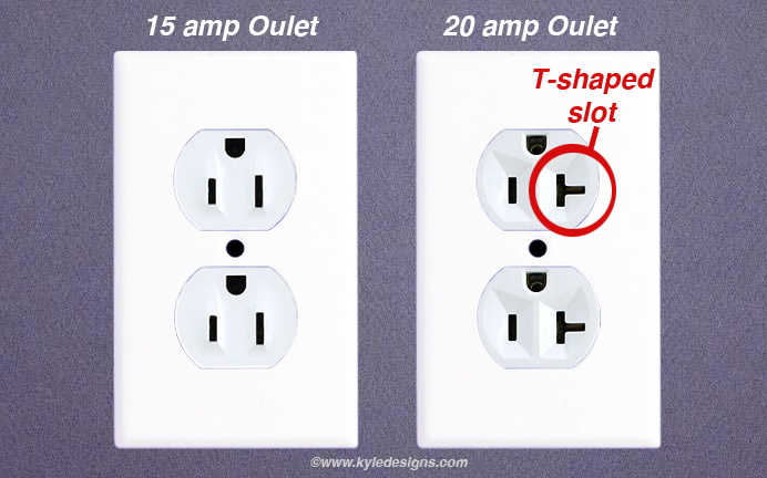

A bit of trivia that some may not be aware of - Here are pictures of both 15A and 20A receptacles. It is permissible to put either 15A OR 20A recepts on a 20A circuit, so if you see a 15A recept it could still be a 20A circuit. However, it is not legal to put a 20A recept on a 15A circuit, so if you see one like the right-hand picture it will be a 20A circuit, unless of course some bonehead DIY'er installed the wrong one.....

Bathrooms, for one. For a number of years the NEC has required it (my copy of the 2005 version does, I don't have an older copy handy).
In my experience, most of the bathrooms and kitchens have GFCI outlets... You can get 15amps out of it... I try to keep the lights off to the places I clean as it draws power from the room.... I've seen outlets on stoves in @Willy P pictures here, but I've never seen one in Hawaii.....It tripped me out seeing it... If you plug into different rooms, most of the time are on separate circuits... I grew up on portables and doesn't bother be to clean with them, just slower...

Nate, are you saying that a GFCI on a 20A circuit will not supply more than 15A?

What is the best gadget to check the amps in outlets?

What Rico said - there isn't any kind of instrument that I know of that will tell you ampacity just by plugging it in...
I dont have a single one of those in the new digs...
The only place you're likely to find a 20A recept is where there is ONLY one recept on the circuit - typically where the washing machine plugs in (laundry) and if there is a dedicated outlet for a window (wall) AC unit.

The problem is that what comes out of the outlet is exactly the same for a 20A circuit and a 15A circuit - until you exceed the trip rating of the 15A breaker - then of course it trips and then nothing comes out.
You could build a tester that plugs in and draws 19A when you push the button - if it doesn't trip the breaker it must be a 20A circuit, if it trips then it was a 15A..... Do you think I would sell many? :clap:
