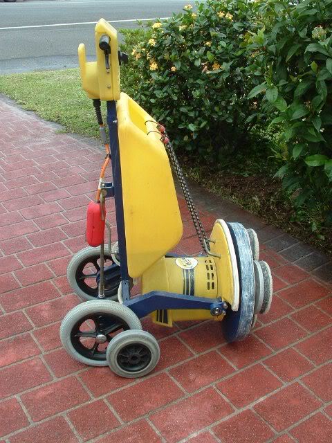

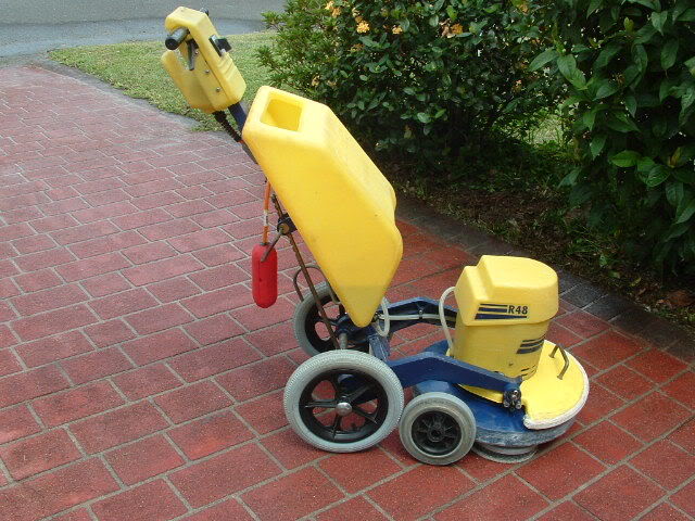

This makes it so much easier to take the Big Yella up 3 or 4 or more flights of stairs.

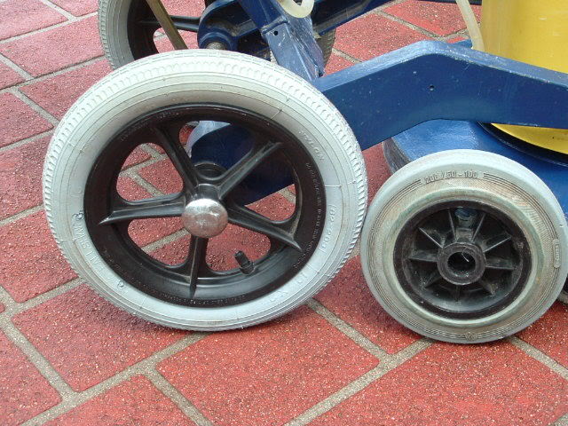

It's no big deal, just get the wheels, ream the centre hub out so they will slide onto the axle, and you're ready to rock 'n roll.
Also makes Big Yella so much more easier to use on the flat.
Put the handle upright for tight areas.
Goes over sandy or stony ground a lot easier as well.
Ooroo,
:roll:

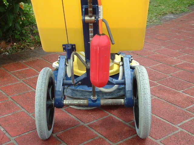

Oh yeah, people ask me about the red box.
I cut the lead and have a short lead inside the box.
The box serves two purposes.
It locks the two leads together, and it also helps stop any water from getting to the leads.
I do a lot of lift lobbies that are quite small where I only need alead about 15 foot long.
This saves having fifty foot of cable laying on the floor that has to be rolled up & unrolled each time you move floors.

I don't understand you Jeremy. :?: :?:
Why would you want washers and wing nuts on them, :?: these could scratch the walls, etc;
The wheels stay on permanently, mine have been on for a long time now with no problems.
The hubcap is a smooth end to the axle and there is no reason to remove them nor the wheels.
