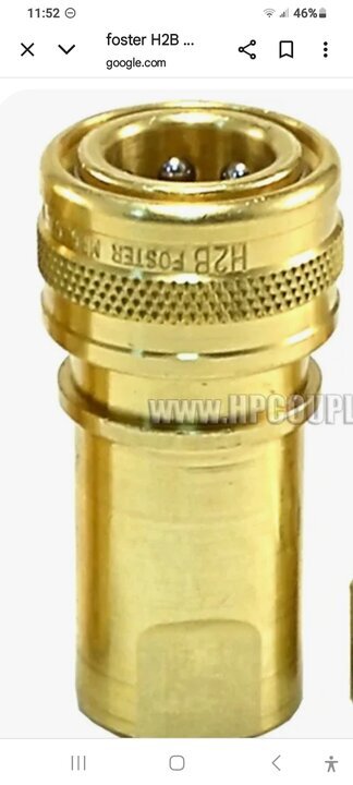

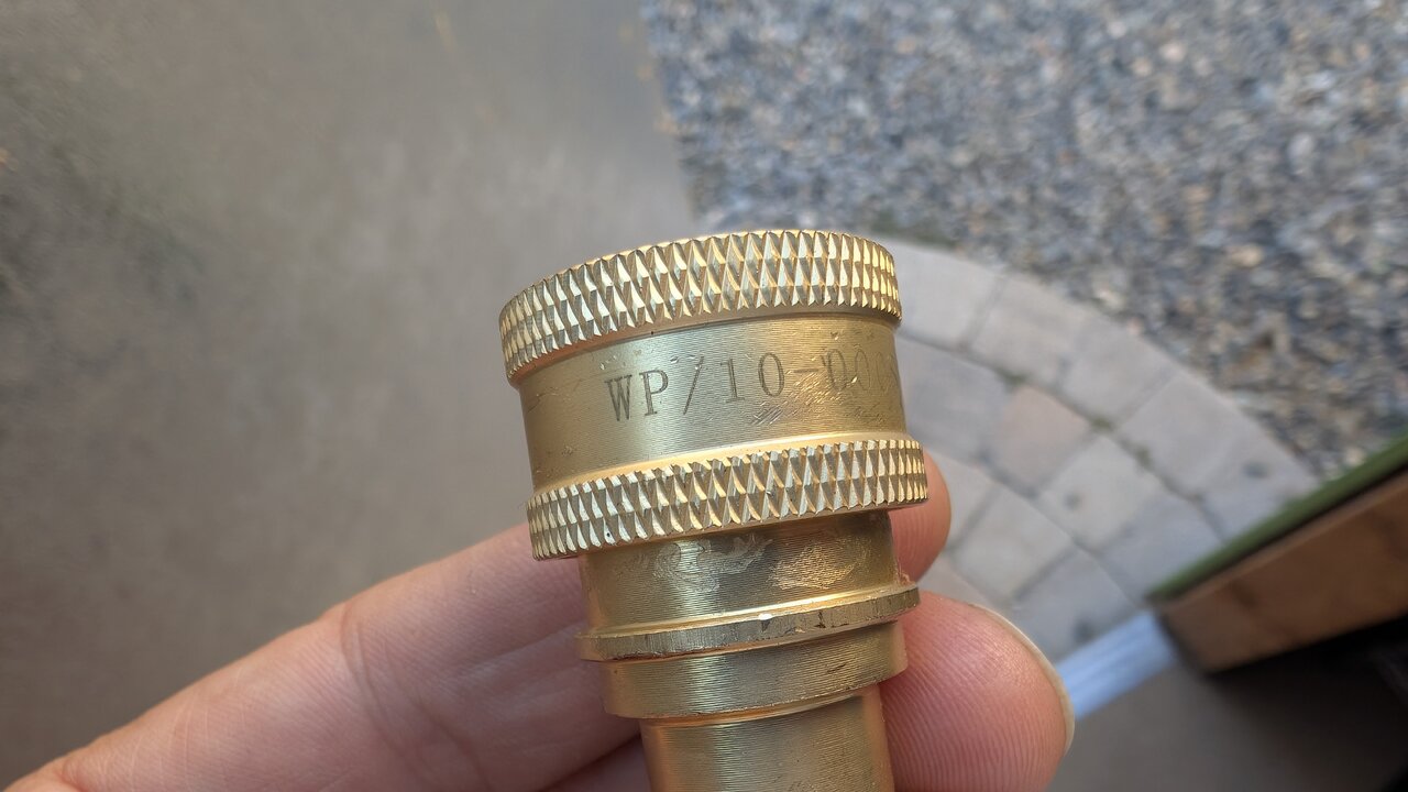

Im willing to bet if you push the quick connect outa that plastic cover, you'll find its a foster FHK series H2B female quick connect. It'll be clearly engraved on the knurled slide lock. They're the best in my book

Sounds like a win to me. I'll definitely be grabbing these moving forward. Thanks a bunch Dwain.

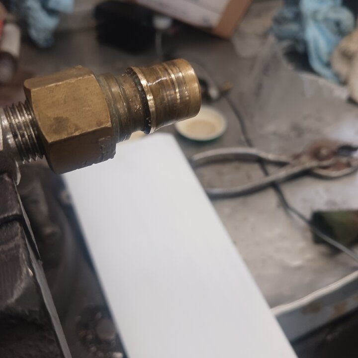

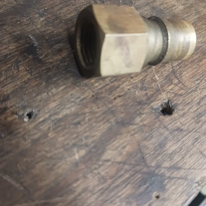

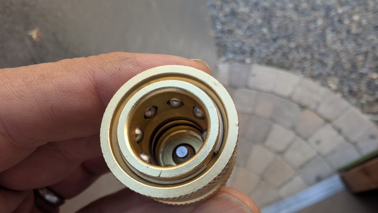

When the males flare out and no longer fit and they all do no matter what brand. ( its the pulsating hammering against the ball bearing locks) an easy fix is to gently grab the high edge with a pair of pliers or small channel locks and LIGHTLY LIGHTLY! run the jaws around it to remove some of the high metal and it'll fit and work again. This can be done several times before the bearing wear away enough metal that the connector eighter doesn't hold connected or the puppets no longer open enough. Remember your only tryin to mill down enough metal to facilitate an easy fit not grindit down to a nub. You dont have to remove the qc from equipment as long as you can get all the way around
Reactions: Bryce C
28,275
View attachment 131973 View attachment 131974
Yes, I have done that but they tend to leak at times.

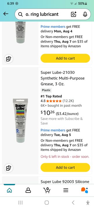

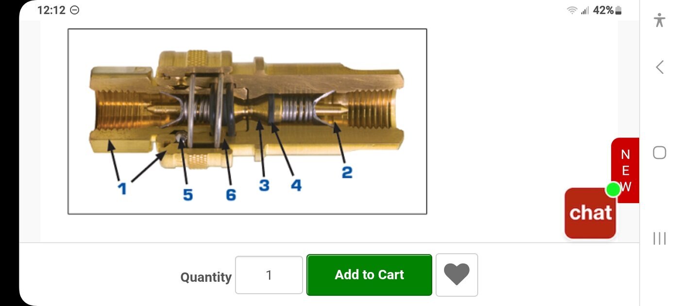

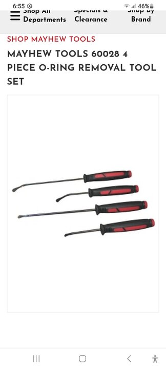

Leaking is a different problem with a different solution. Sticking is the ball bearing locks and is higher up on the male quick connect sealing has to do with the orings inside the female end for that replace the orings. Third problem with quick connects is flow that has to do with the poppet valves eighter Sticking or plugged up with debris. My suggestion is if you need orings to stop leaking. I strongly recommend that you order them from your supplier, rather than buying a generic Chinese assortment from somplace like harbor freight. And if you, like me order a bunch to have on hand cover/ coat spares with oring lube such as parker lube so they don't dry out and deteriorate while in storage. It is important that you don't use just any random grease as it will probably expand the oring rendering it useless when needed. Amazon, walmart.com, ace hardware all have a suitable product. Just make sure oring lubricant is in the name. Also use pointy picks to remove and dull or rounded tip picks to install as to not damage new ones durning installation
Screenshot_20250802_183631_Chrome.jpg Screenshot_20250802_183730_Walmart.jpg Screenshot_20250802_183949_Amazon Shopping.jpg Screenshot_20250802_185611_Chrome.jpg Screenshot_20250802_185536_Chrome.jpg Screenshot_20250802_183906_Amazon Shopping.jpg

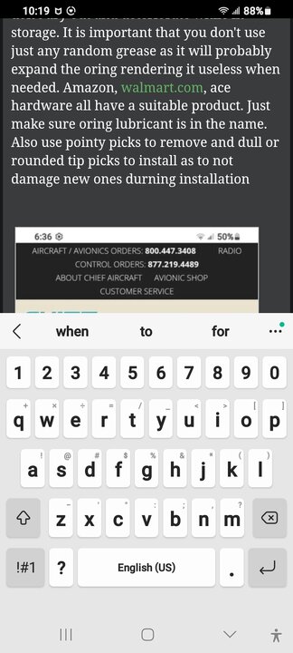

Petroleum products cause some rubber orings to swell.
Not all rubber orings are the same.
Petroleum penetrates rubber making it larger.
Dwain Ray
Jul 22, 2020
1,175
Precisely why i said don't use any random grease it will probably expand the oring rendering it useless . However expanding the statement to include all Petroleum products does make it more idiot proof . Im older and I keep forgetting that we live in an era in which vehicle owners manuals now have to include such statements as do not drink the fluid in batteries🥺
View attachment 131978 View attachment 131979 View attachment 131981 View attachment 131982 View attachment 131983 View attachment 131980
Good advice. Thanks Dwain
