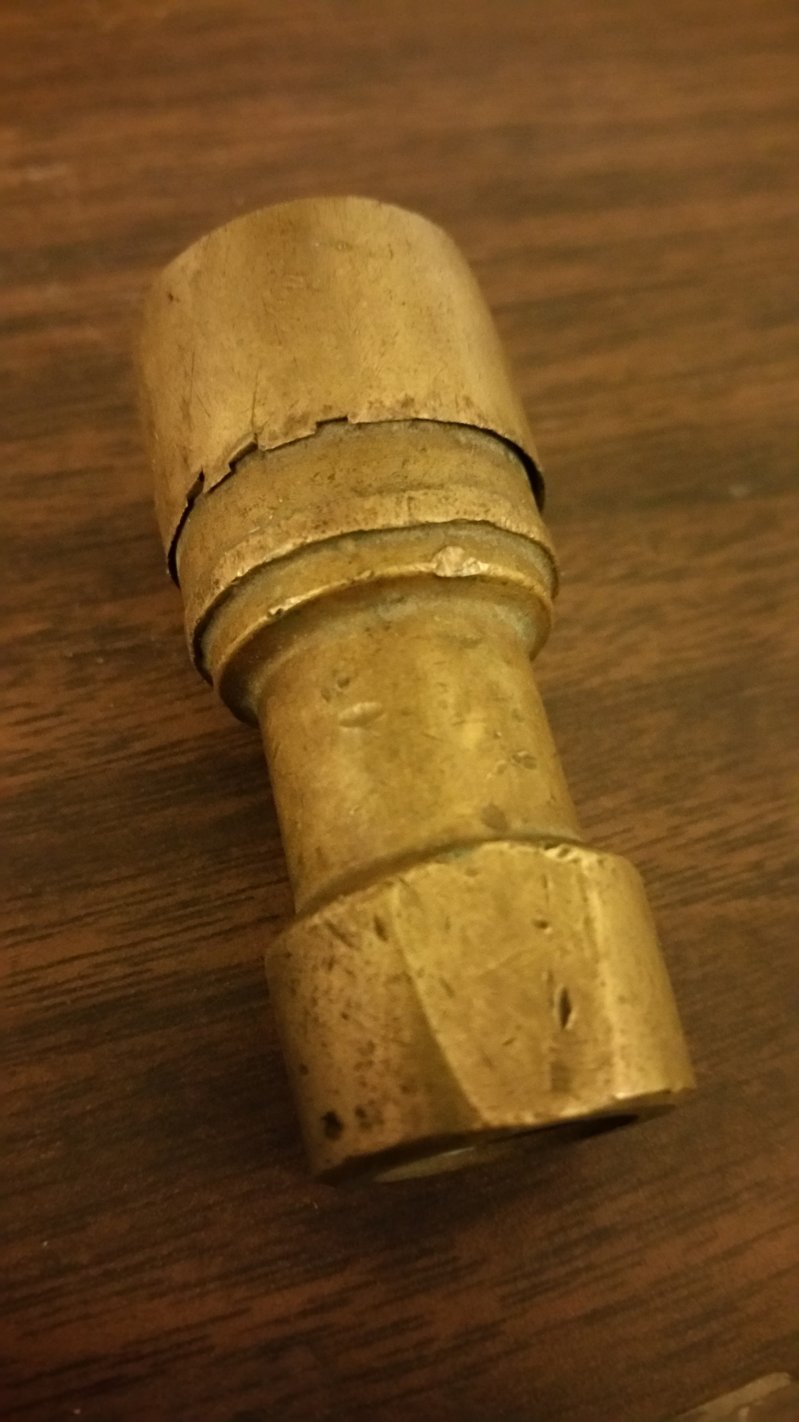

It's not mine btw..
For me, it's male on my tools.. Heat and dropping it on concrete from the second floor is the biggest killer for a females.. You can drag her around all day!
