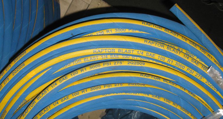

Just a note to our TM hose customers...
that the Raptorblast 275° F hi-temp hose has finally arrived.
Thanks for your patience,
Larry

This RaptorBlast hose was used to prevent the "neptune" hose failures.
The inner tube is much more resistant to carpet cleaning chemicals.
Larry
