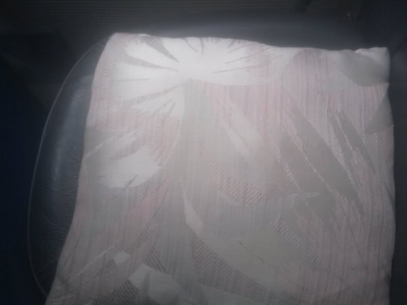

this is a loose cushion. The whole uph is this fabric. This cushion has been cleaned with the HK tool and O2 prespray. Seemed to work ok.
