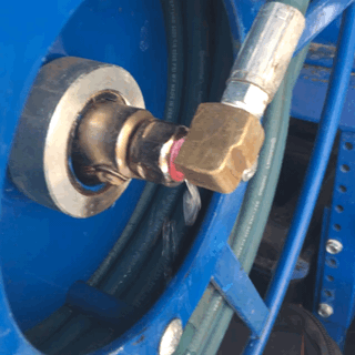

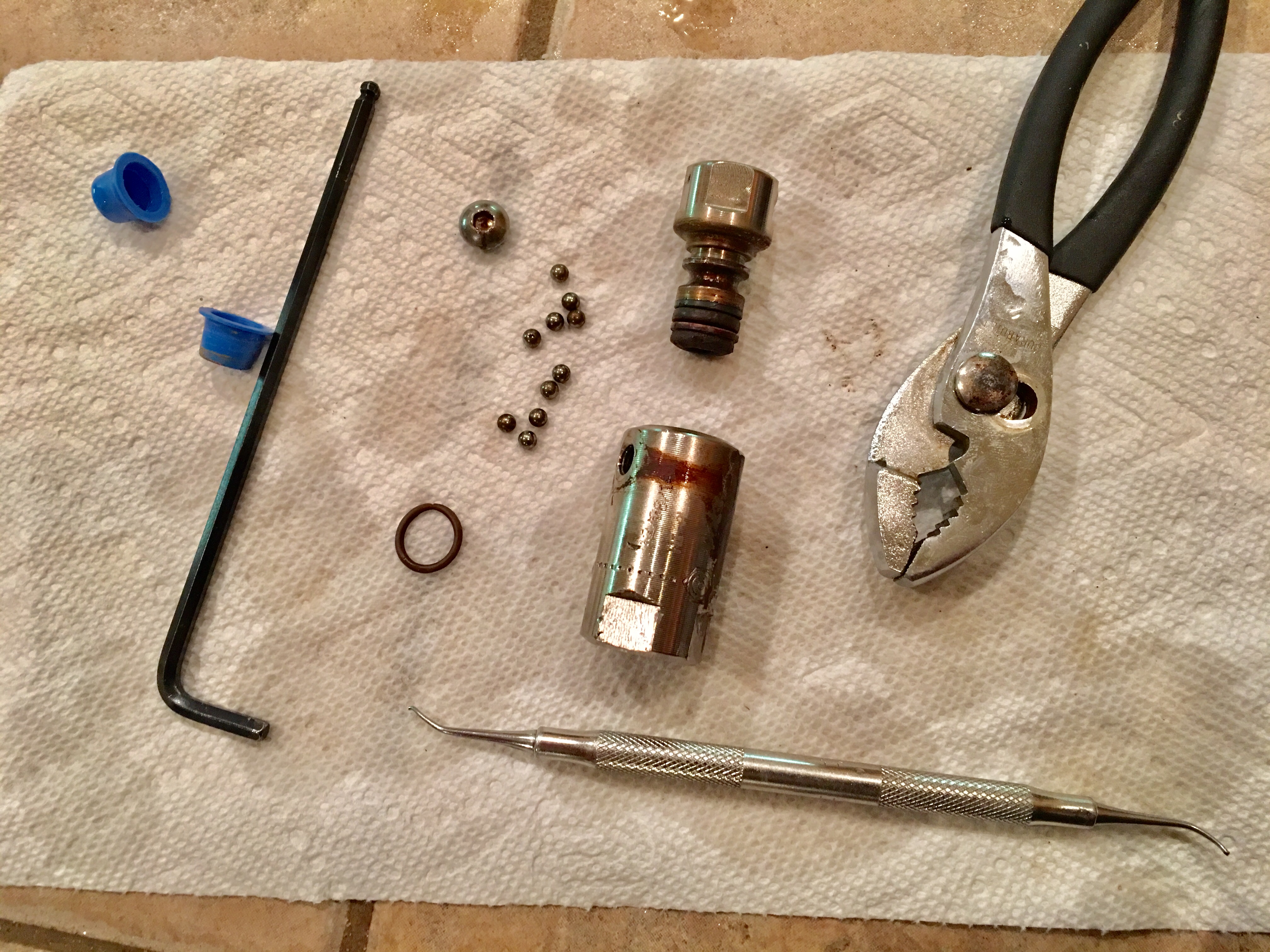

I get about 6-8 months from my Super Swivels. My current one is leaking pretty bad so I took apart an old one that was also leaking. I’m going to try and use new Ace Hardware O-rings and see if that fixes it. I did order a new $40 swivel, but i want to see if I can. I know my little ACE Hardware fix may not be a Viton o-ring but im interested to see if it will work.

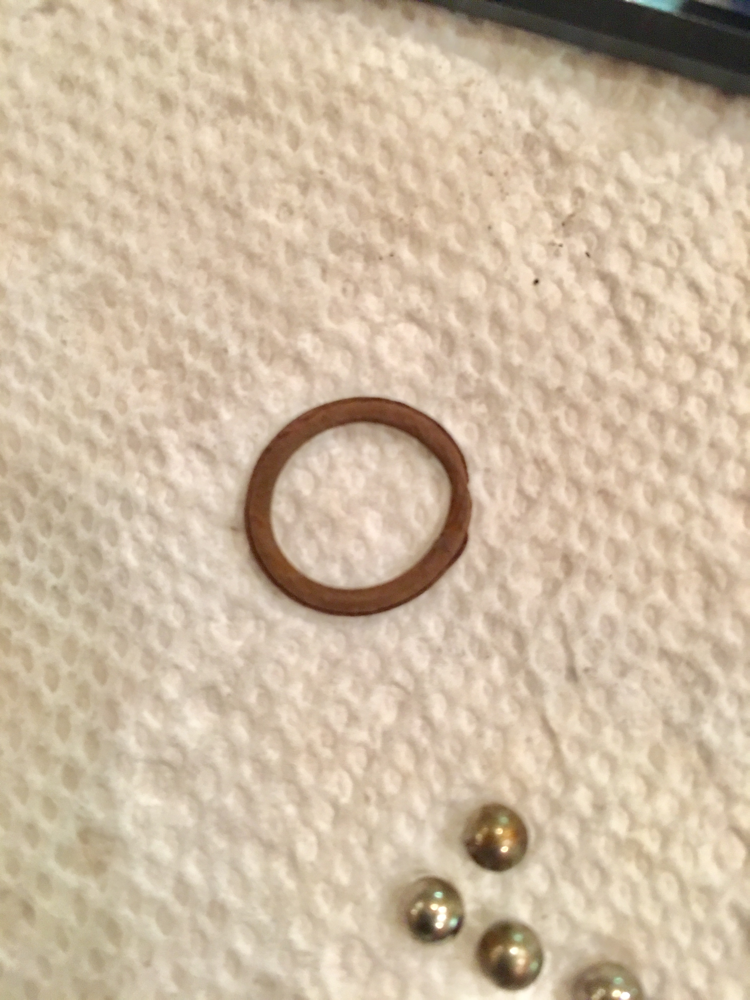

You can see in the pic the O-ring wore out.
23,897
Redding
ace hardware should be fine
but they also sell rebuild kits got like ten bucks
Yeah. I saw that. I didn't know what kit to get. There were many to choose from. I’ll call them later and find out the exact kit. Maybe stock up on a few.

I was going to say I bet those orings don't hold up very long.
Add metal fatigue to the equation and its often best to replace the whole thing.
