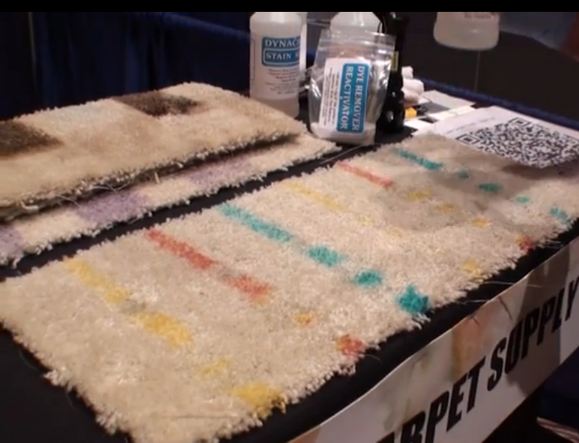

We use several of them for removing Dye Stains:
Nothing more effective on any synthetic or disperse dye spot . . .
with an experienced technician . . .
Video Link : http://bcove.me/j2bzbqag

Neither most of us, but we live in the real world.
The issue also boils down to time.
In the old days, we were supposed to do the three cycles of spotting. Very time consuming. Not practical in most cases.
Are we willing to do (is the client willing to pay?) all the necessary steps as Shawn describes?
Exactly, all the steps are not required .
The video in post #2 above showed removal of three aged food color dye stains
in about 40 seconds.
