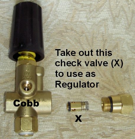

So I changed it out with what looks to be exactly the same as the one I removed. Problem now is the gauge reads zero until I trigger the wand. It also is impossible the undo quick connect now even with pump off. I can also hear the engine work harder when I trigger the wand now, something it didn't do before. Seems to me I may have heard something like this before but don't remember the remedy. Can anyone shed some light on it for me. It's a PowerClean.

I did change the plug from one side to the other for my application.
I didn't see a thingy in there.
