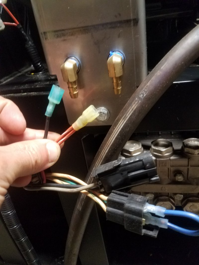

I am going to take my Prochem Apex out to put in a new waste tank. I was wondering about how the fuel line is hooked up.
Any info would be nice.

There is probably a hole drilled in the floor where the fuel line comes through. From there it should go to a fuel pump. I would take the clamps loose at the fuel pump. You may have to cut the line to get it off then put a plug in the line until you're done.

There should be two hoses and two wires..

Remember to take the two little hoses off your waste tank also.. And disconnect your waste tank float sensor.
