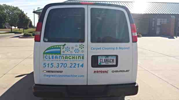

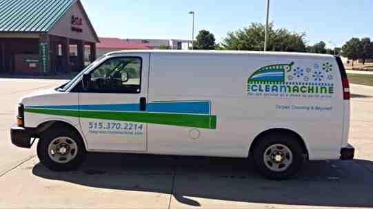

Has anyone done it themselves? My vinyl has been on my truck for @ 5 years and I may be selling it soon. I want to get it off without damaging paint. The heat gun thread made me think that might work, any suggestions? Should I hire it out from the sign company and be done with it? Thanks.
