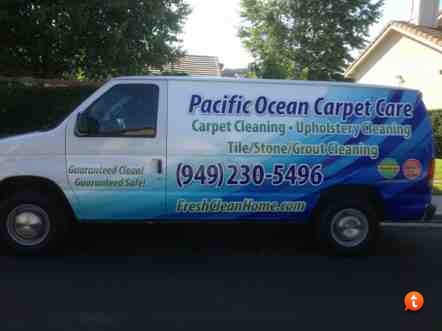

Let the lettering get hot in the sun, then Peel an edge with a fingernail and it will peel right off, goo gone or gum gel takes the adhesive off, then wash. Once washed clay bar it or have it buffed to remove the fade that happens. So it looks all nice and new again. Then use a paint sealer, then wax. Then get your new graphics put on.
Sent from my HTC6435LVW using Tapatalk
Exactly what we did! Here's the new wrap
