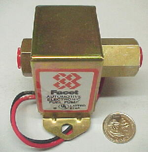

Maybe they never put a fuel pump on your machine. I had that happen with my 1st TM..
The pump will be about the 1.5"x3 inches. hose going in, hose coming out. 2 wires.

Becker
This is what you are looking for.

arghhhh!!! they sold you the wrong pump!!
The valve cover mounted Kohler pump is fine for power equipment, but wimpy for pulling gas up from the van's fuel tank instead of pushing from below like most TM's need. It will perform poorly with long fuel lines and vapor-lock prone hot weather conditions.
I promise just about every AutoZone, Advance Auto, Oreilly's, NAPA, Pep Boys, or local parts supplier has the pump pictured earlier in this thread....for about $40.

AutoZone doesn't carry that Facet pump... or one that looks like it.
Advance Auto parts carries a P.O.S. made by, "Mr. Gasket", that has a failure rate of about 33.3%, based upon personal experience.
PepBoys doesn't carry it... at least not the one near me. (I'm not a big Pep Boys fan, anyway...)
NAPA carries it... for $40 to $50, depending upon what store you're in that day, it seems. (Some stores charge more for the lower PSI version, for some reason...) It's made by Facet, but it's black resin... not metallic.

Get a pump Like I showed you in the pic..
As I recall if the van is fuel injected you need an electric fuel pump.
I had a Kohler 25hp.. The goofy guys installed it without a fuel pump. That lasted about a week.
