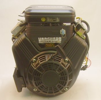

My boxer will not stop leaking from the rear seal
I am looking to replace the motor
Anyone have any experience in replacing the motor on a 2003 Boxxer 421
I know the original motor cannot be purchased today
Is there a Honda unit that works ?

Spurlino
385447-0173
http://www.smallenginewarehouse.com/searchresults.html?
Manufacturer:
Briggs
Price:$1,300.00
In Stock: 20
Compare
Fort Worth , Texas
You can replace the seal and it will last 100-1000 but it will ride out again.
If you want closer to 1000 hours( of course only if the motor is low hour) coat the lip seal with a bit of rtv silicone, seat it and let it set up for a few hours.
