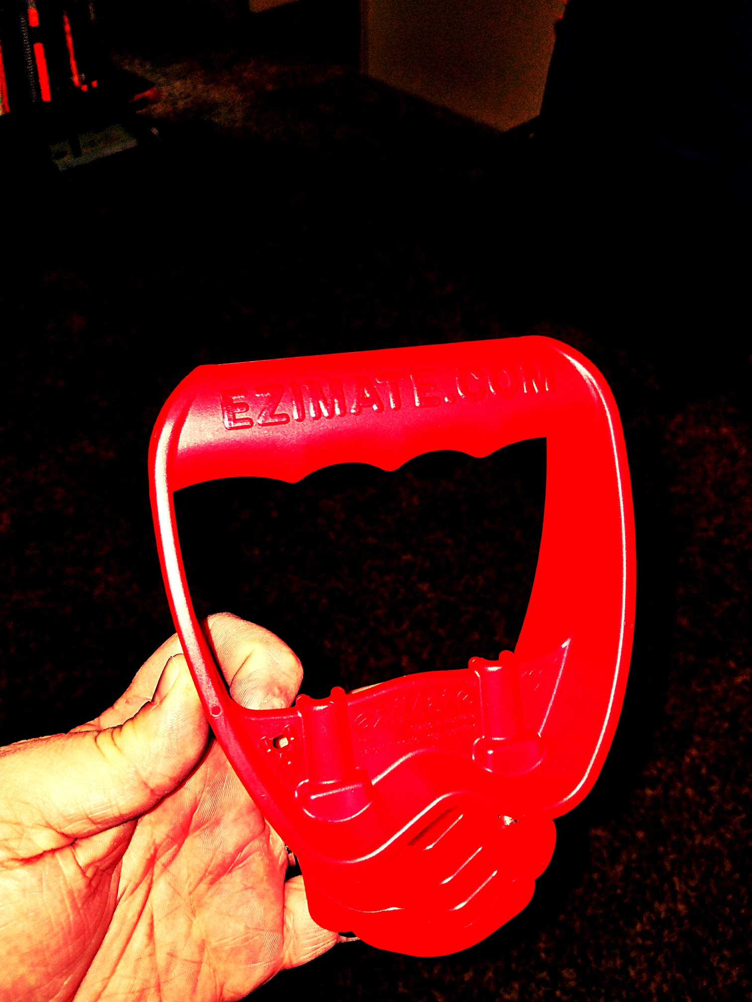

Where can i get the hose for the wand to replace the metal tube..
Cuz i cant get this on!

Its plastic..it would get compromised
14,624
That stainless steel tube is more important that that red handle. You don't want a hose, unless you get the black hose with brass fittings. Call PMF and see what they've got. Anything else, and you'll be replacing the hose every year because of rust on the hose crimps.
So if the handle won't fit, return it.

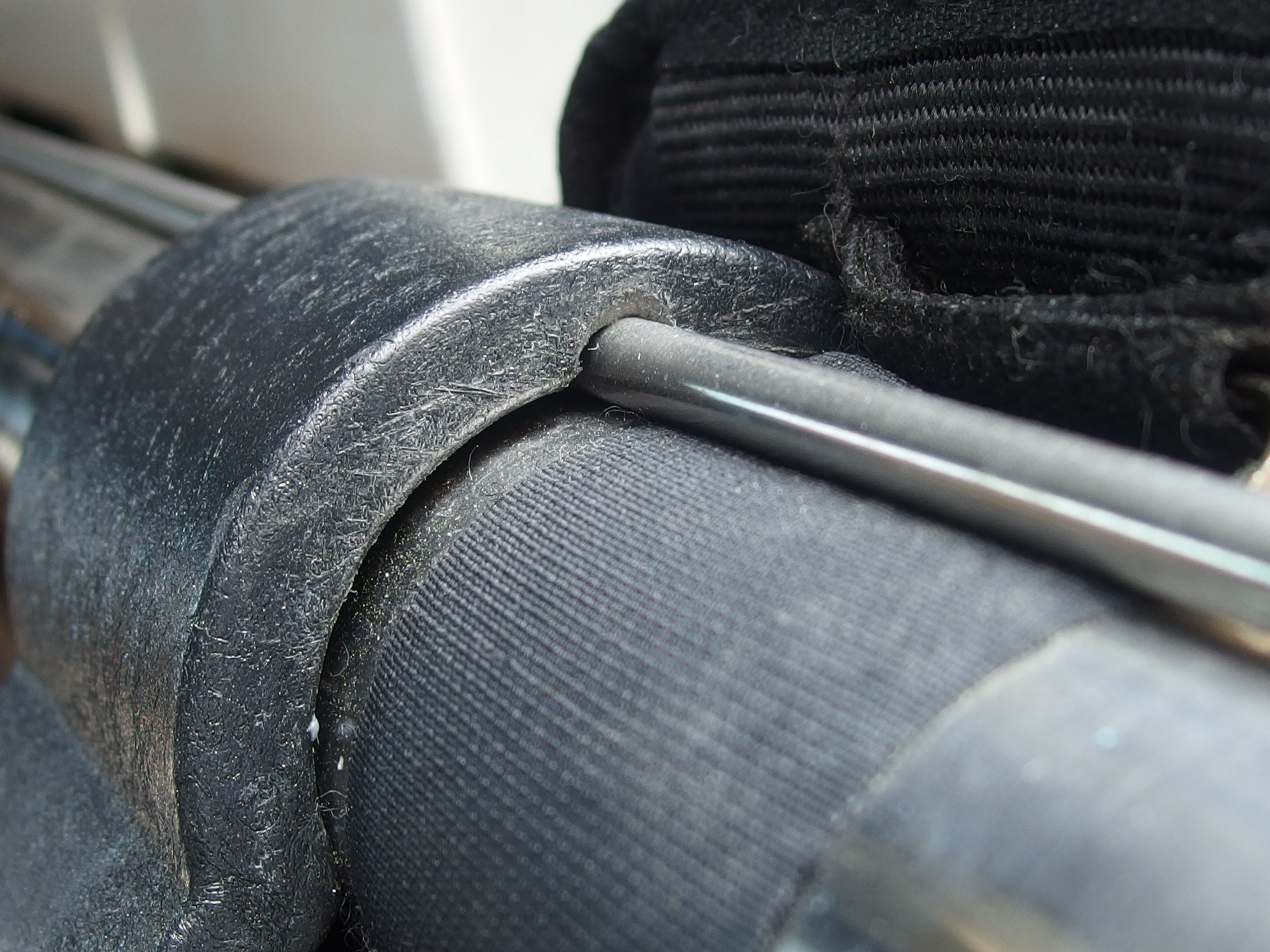

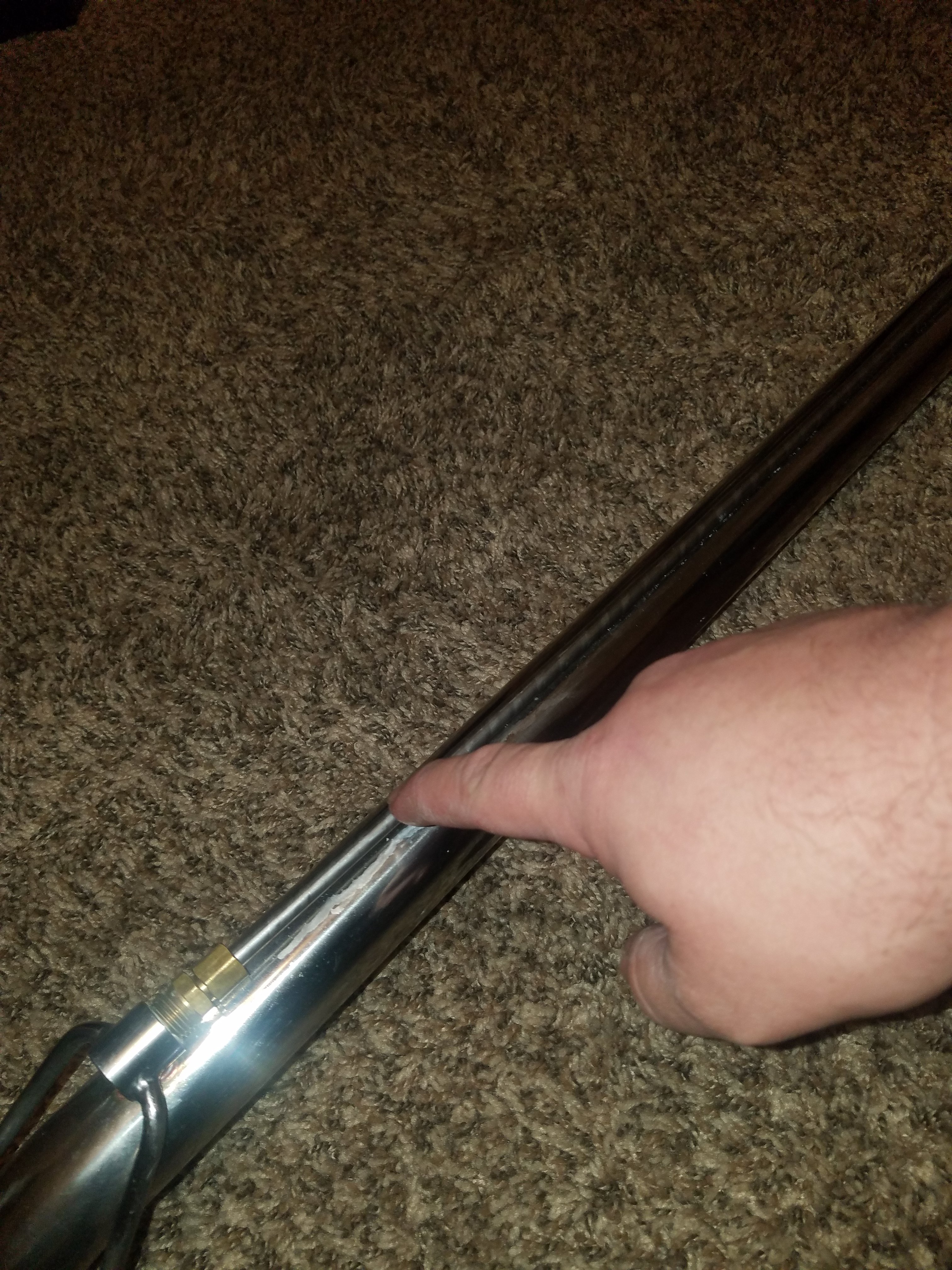

Thanks. I wasnt sure..i never thought of pnuematic shop for hose. The problem of the my wand jet tube does not stay close wand as it approach the trigger. So notching wouldn't work.
28,263
It looks like it's just stainless brake line with flare nuts. I get mine at the local auto shop.

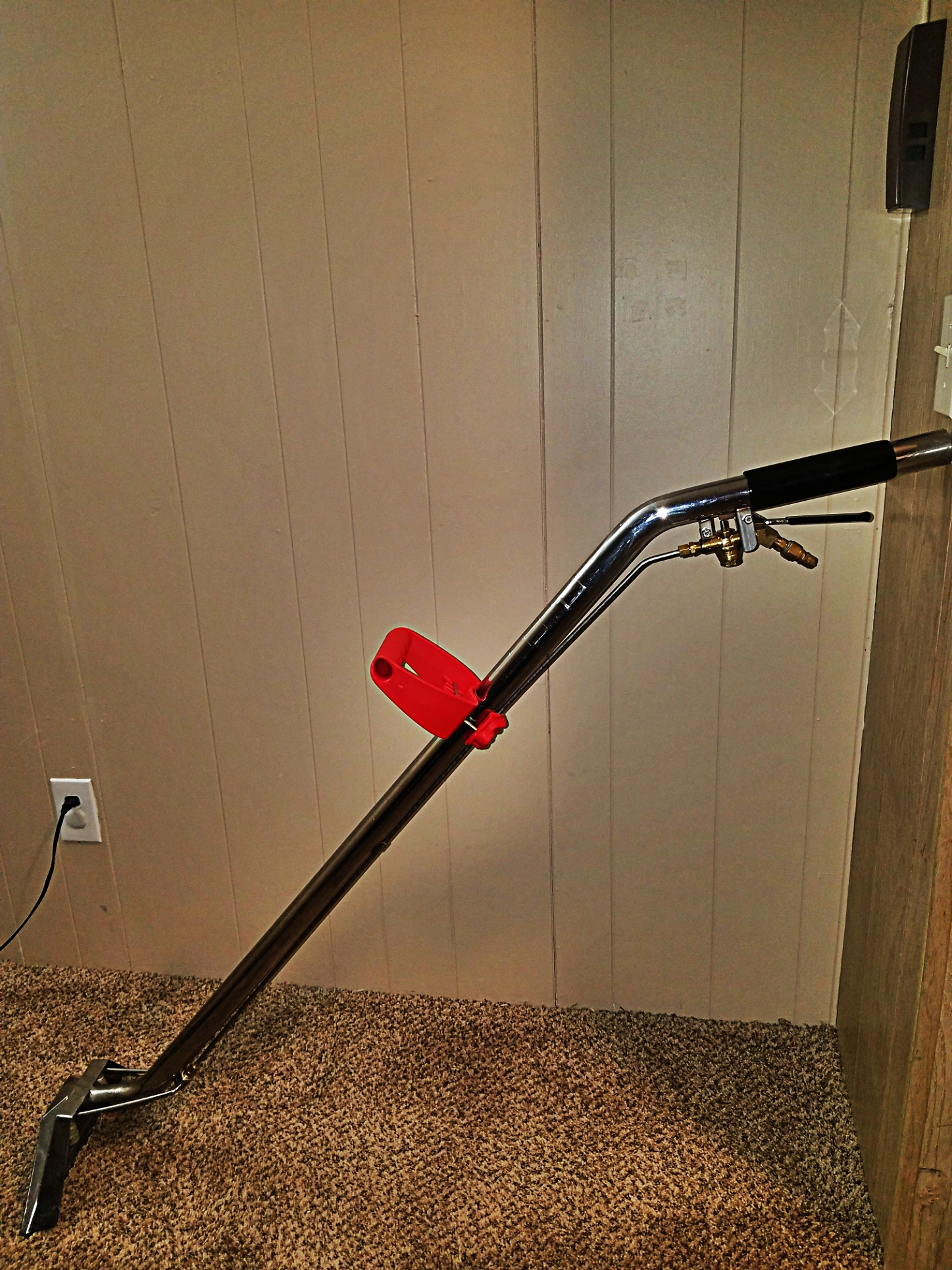

I like my handle up higher closer to the bend so I can push it and pull without bending too far forward.
I dont use handle to push or pull, only if i need to carefully manuever or reposition.
13,372
I tried that and it made my shoulder hurt more. I had to move it lower so my arm is stretched out more giving me better leverage.
