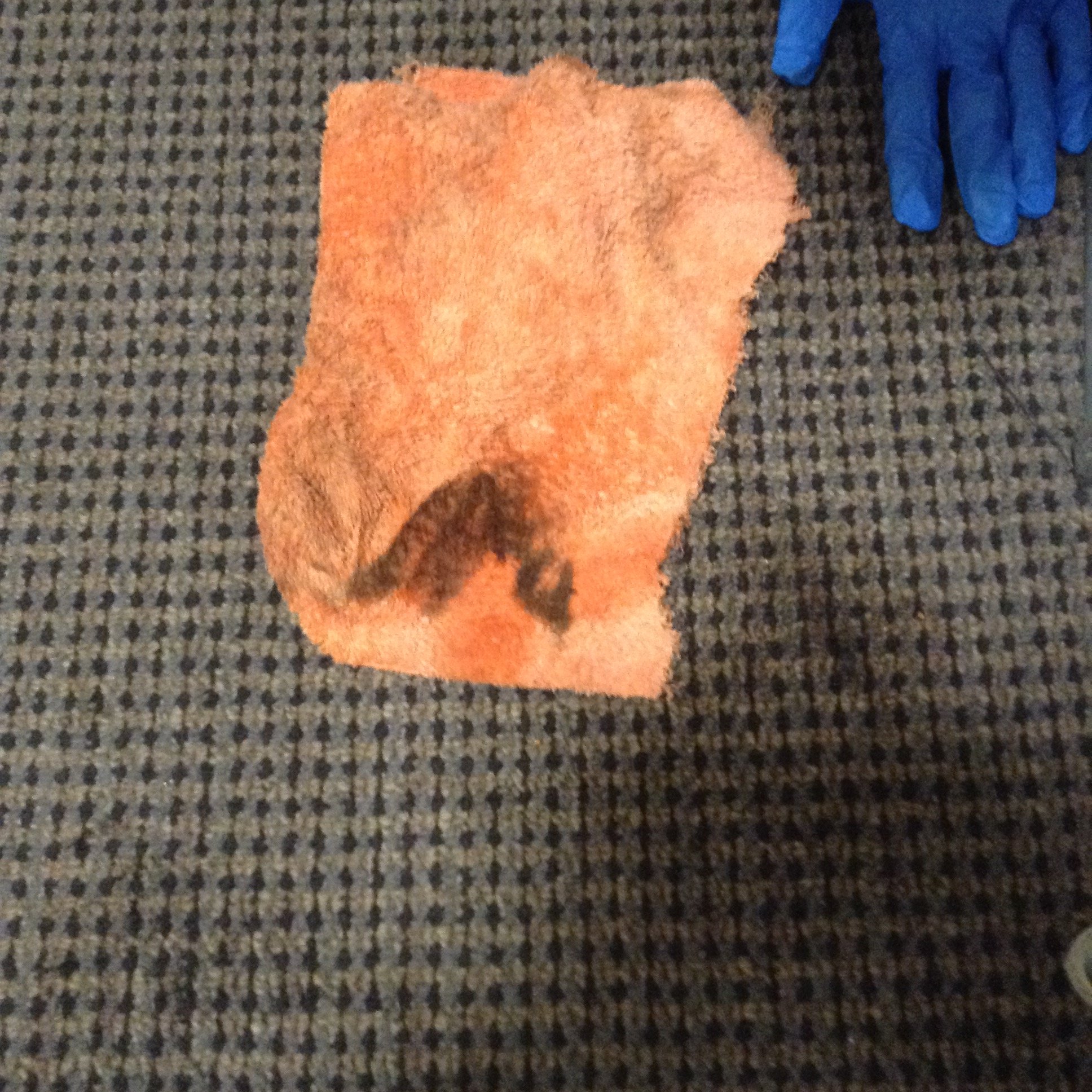

I have a residential building and the top floor all commercial carpet, the roofers tracked roof cement on a ten foot by four foot area! Is there anything to get this out speedy. I'm using a few solvents with a rag but it's taking forever and not completely removing it to an acceptable point.

I had this exact problem. This is where I found out how good Prochem Pro spotter is. It will get that out like a hot knife through butter.
