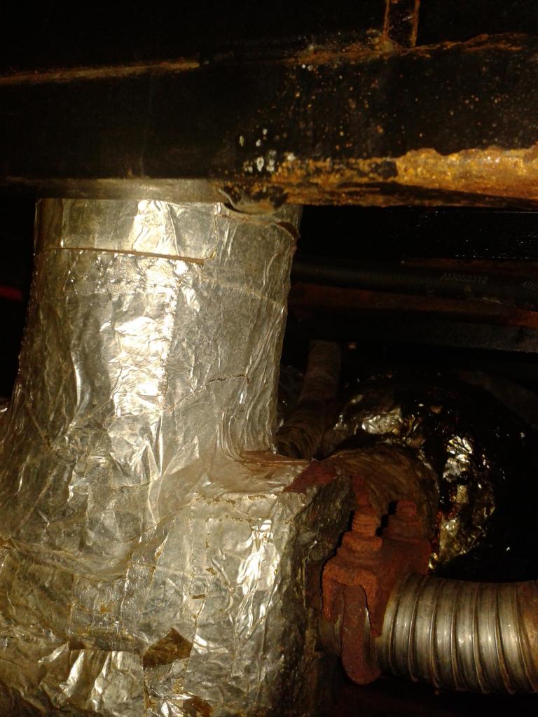

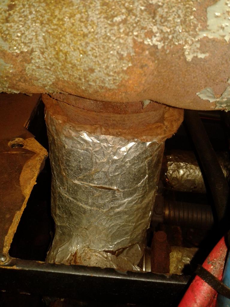

Thanks for the offer, Brad. I have a shiny new blower sitting in my garage. A rebuilt wasn't available. This blower is a beast. My main challenge is getting the old one out and separating it from the blower pre heater. I'm thinking a 2X4 through a chain on the blower might do the trick. I haven't decided whether to take it on this weekend. I don't want to get it out of the machine and not be able to get the pre heater off the blower.

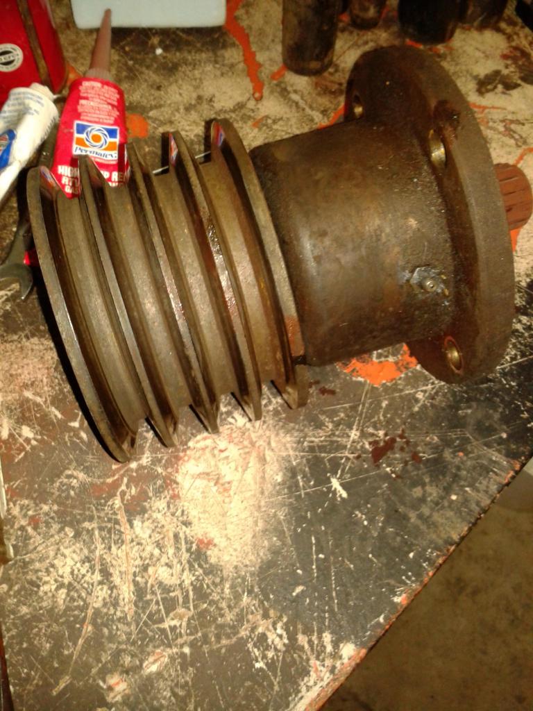

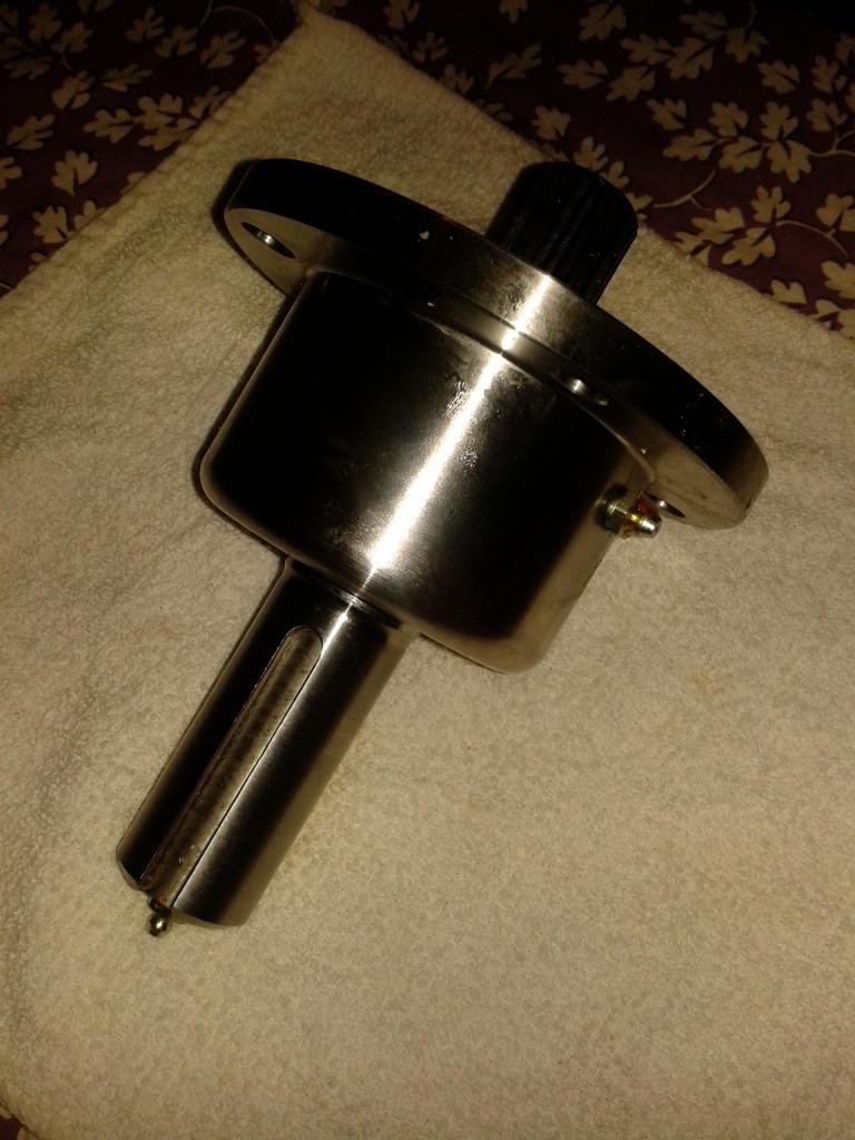

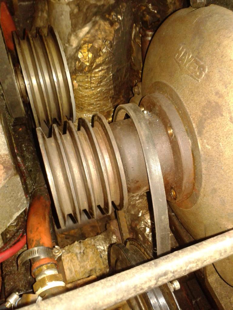

Man, I can't imagine how you're going to separate that blower/HX connection. When they were built, PC didn't think they'd ever need replaced! All I can think is to cut the huge nipple exiting the blower bottom at about the half way mark, then re-connect with some type of rubber/steel clamp connection. What's the weight of the blower? One question I did have.....does your Genny have the Hayes coupler, or is it driven directly from the flywheel? When my Hayes coupler was going bad, it had the same noise. That was easy to replace.p1_zps461e2350.jpgp3_zpsfe04f719.jpgshaft2_zps3d961768.jpg

Here ya go Doug. We just removed this blower today. What you don't see is the hour it took to get to that point.. Good Luck don't destroy your HX box. If you do this one will be welded back together and for sale $500

Yeah, that's what I was worried about. I called Guaranteed Cleaning Supply ( Larry White) and he set me up with a new manifold to replace the pre heater. I was sweating about that part of the project, but that saved my ass.

I still say you should cut the nipple from the blower 1/2 way, lift the blower out, reinstall new blower with the old blower 1/2 nipple or a new one, and use a steam pipe connector to rejoin them up.
