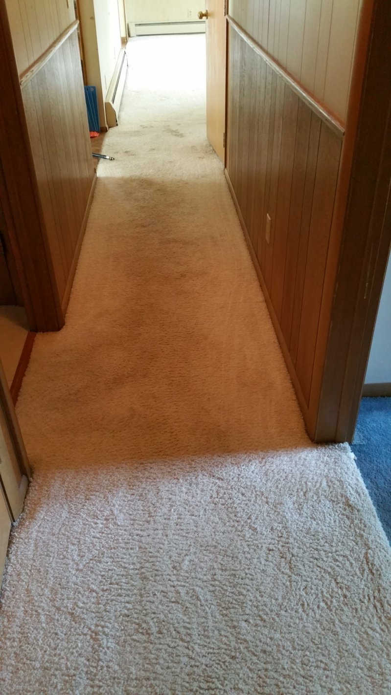

There are just some carpets that respond differently to each method of cleaning.
I have been on wands with no prescrub...to rotaries only, to agitation of many methods and wand, to Zipper....to agitation and Zipper....to.....
Well, I just keep grabbing the tools out of the van until I find the one that the carpet seems to like best....
Some carpets are just plain strange in my neck of the woods and I bring every "Gun" or "Tool" I need to get er done!
And presprays can be a magic bullet too.....
