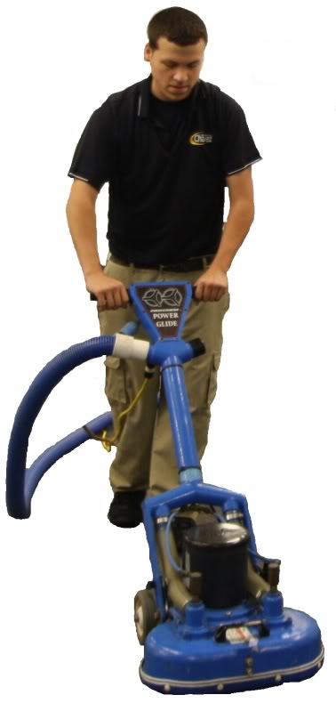

sure, why not, but just like with a wand, you'll need to slow down to get good extraction.
The Powerglide doesn't float, other than that it is built like a tank. We use it on very badly soiled commercial, provided the floor is flat. We have also added Green Glides and it work pretty good on residential too.
Speed still keeps the young guys from liking it but it has been proven to them that it is superior flushing with it.
