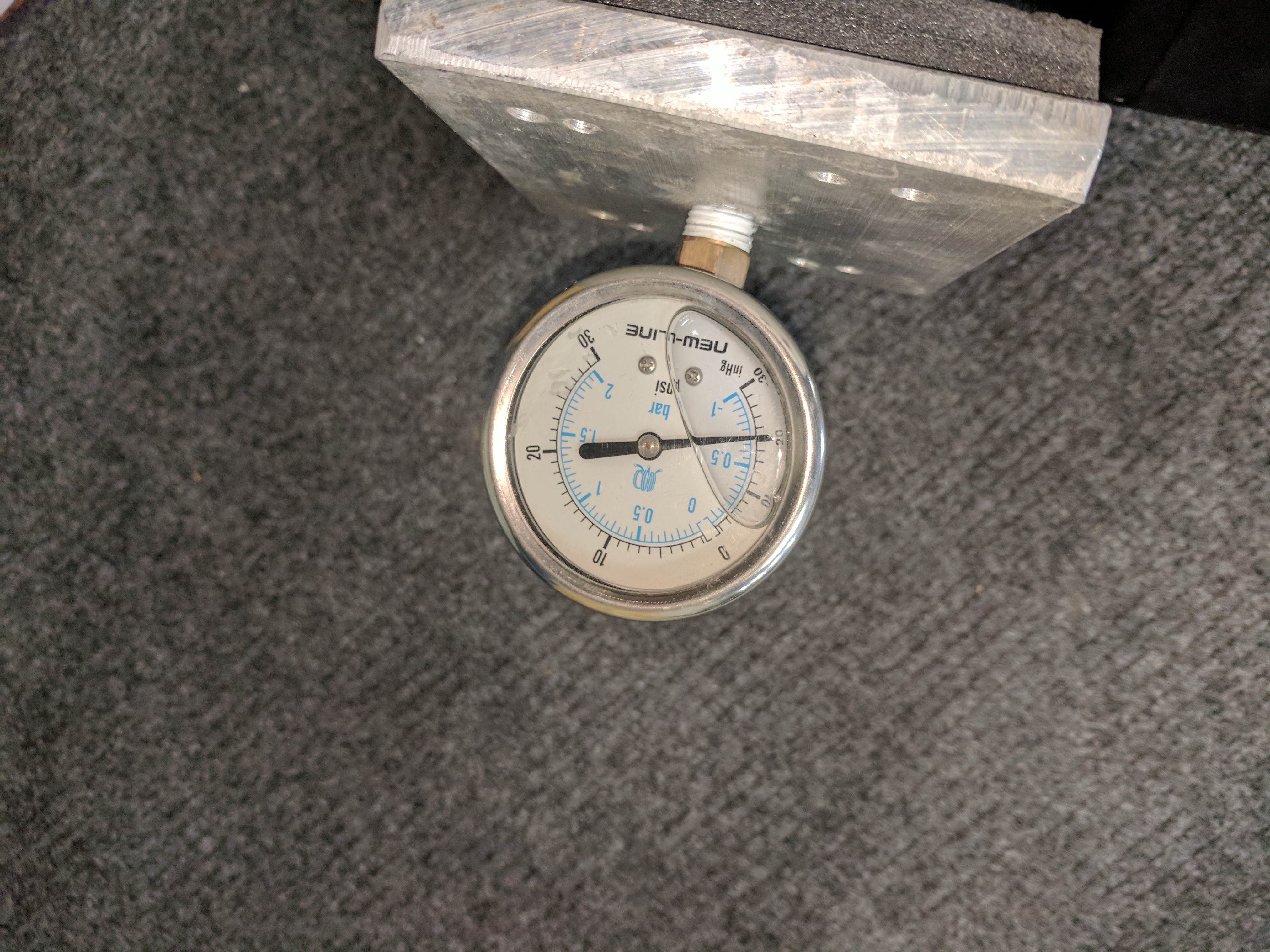

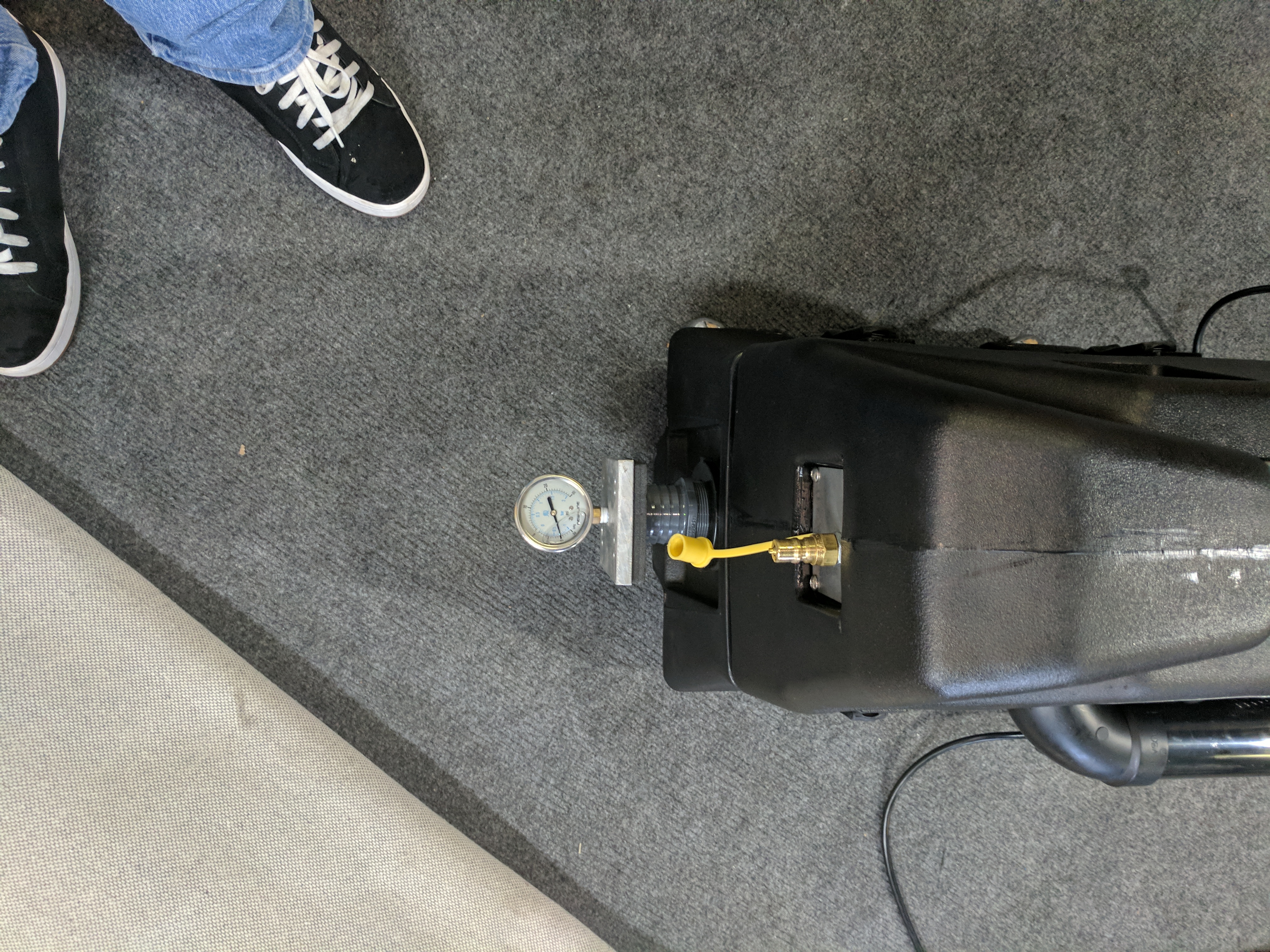

Got my auction Rotovac cfx zx today. Just testing the vacuum and it looks like I'm getting 20 inches hg. Airflow seems to be good. Looking to doing some testing and finding uses for it. I have several pump/motor combinations sitting around the shop giving me ideas.
