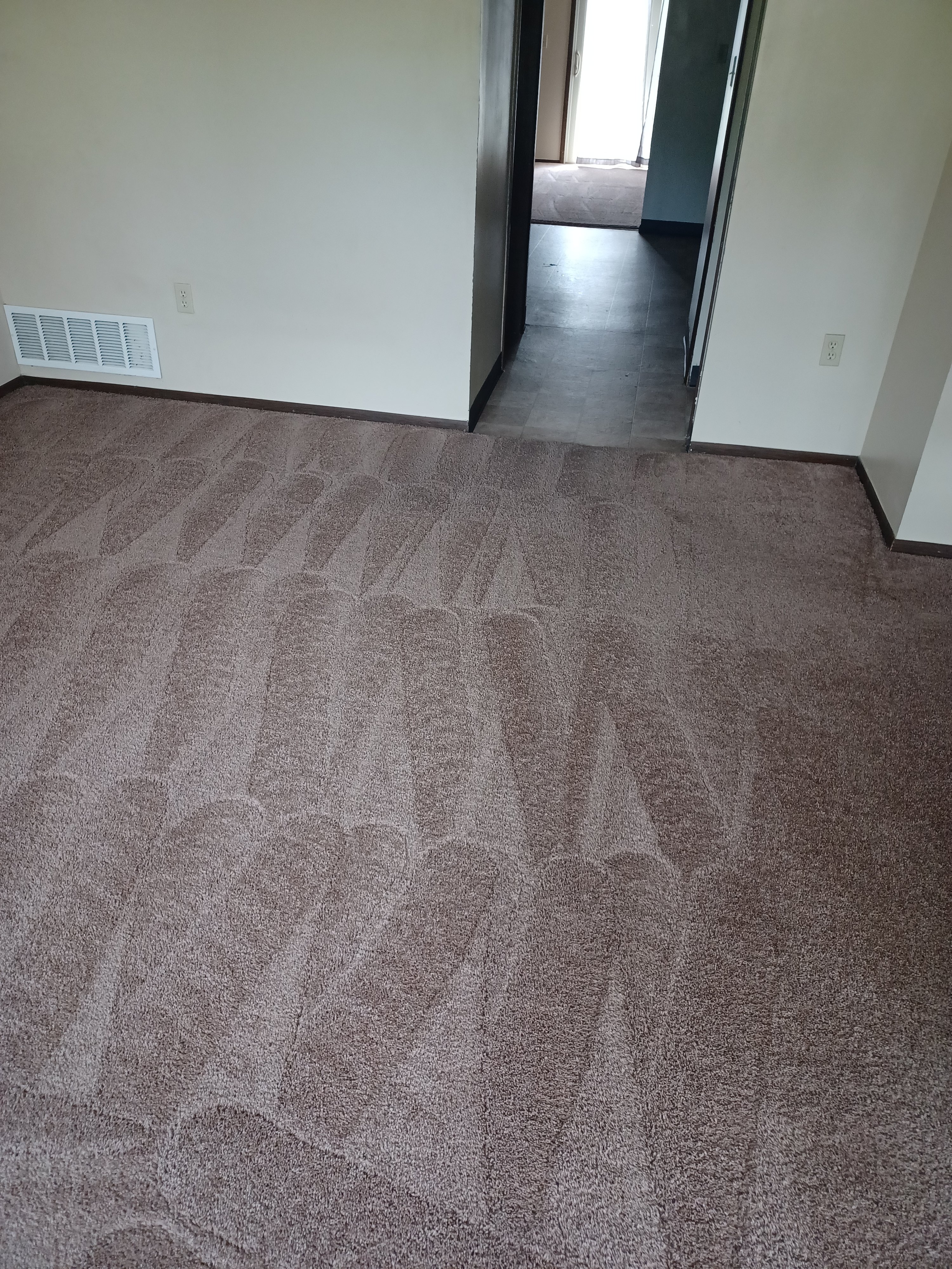

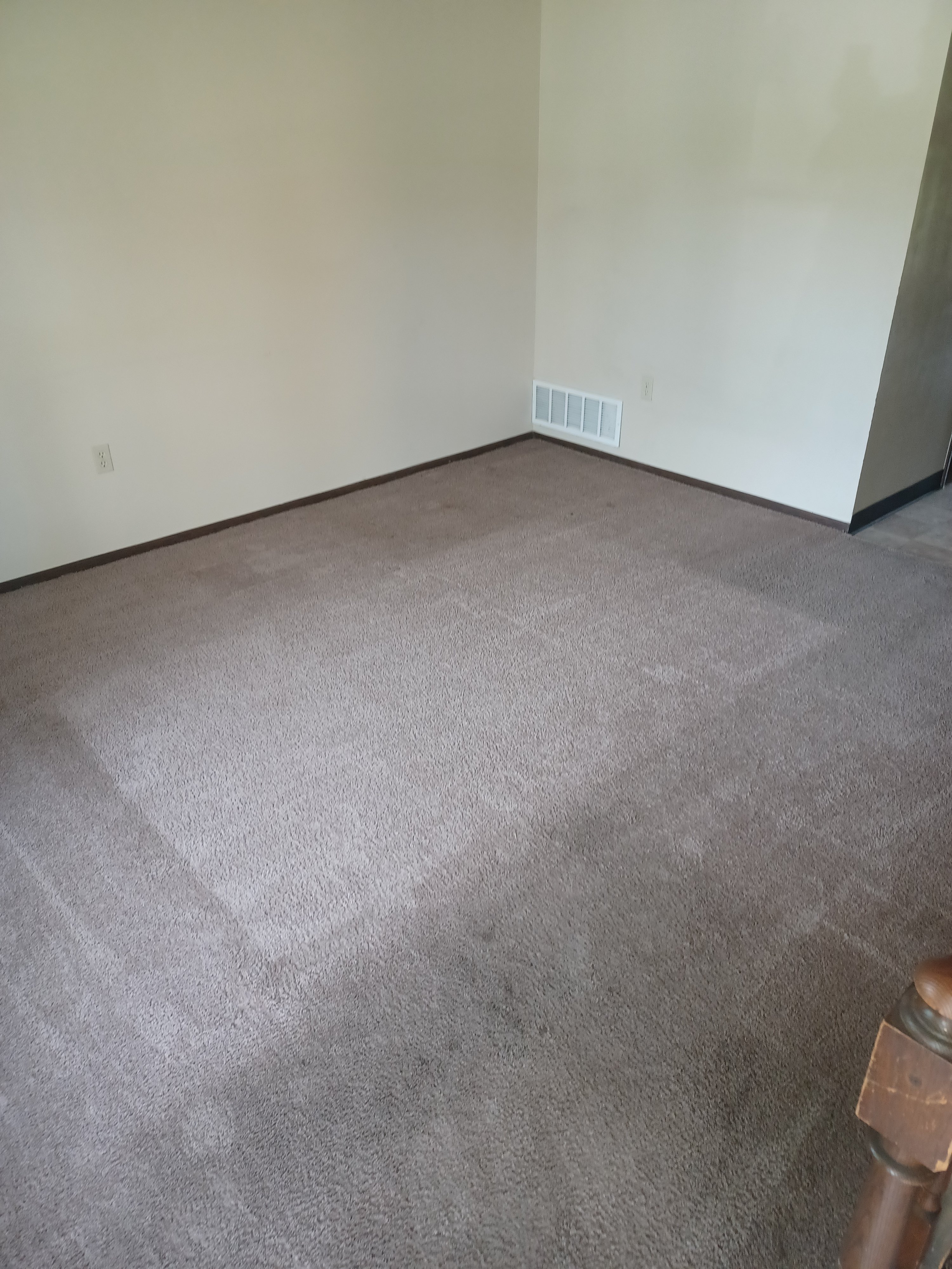

funny, just today, a PET that really was not bad, but , it is poly, and the whole area around where a rug had been laying was going to be a problem , I knew. I used my original 2 head roto, as my 360i was stolen, took my time, even with a lot of effort, yes it looks ok, but, if you were to scutinize, ( which I do to myself, too much!!) you can still see the outline of the rug. Used the neo poly stuff from hydra master, as well as some Power Burst extreme
OH, and the 360i stole it without the heads. !!! So unless they have a source, it is useless.

@Rick J The after picture looks fine to me.. You can't compare walked on carpet to covered carpet not walked on..
Years ago when it first came out I bought it direct from rotovac and the knock-on it was it used Too Much H2O. But you do not need to hold the valve open you can control how much water you put down and let the tool and agitation do the work.
And I experimented both ways and leaving the marks disguises a little bit the wear pattern
