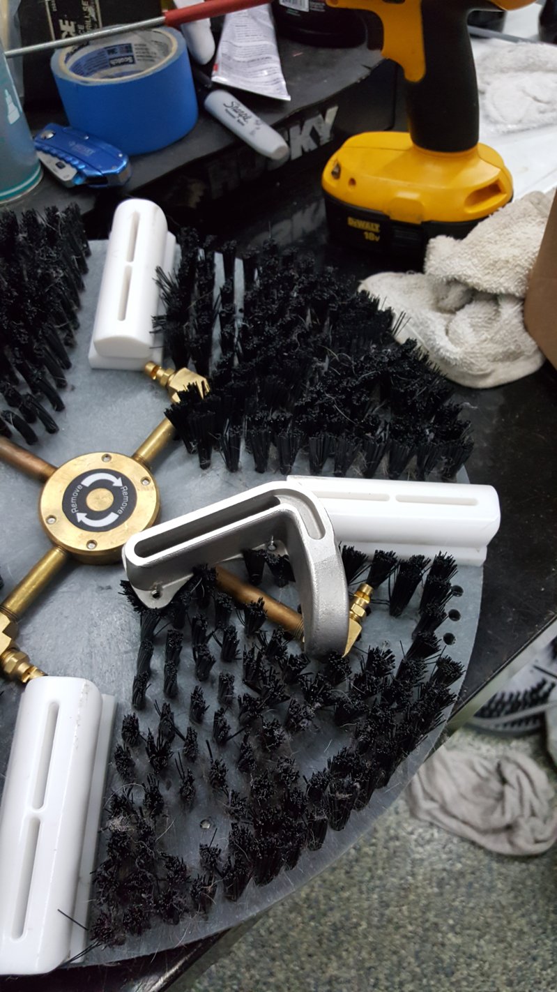

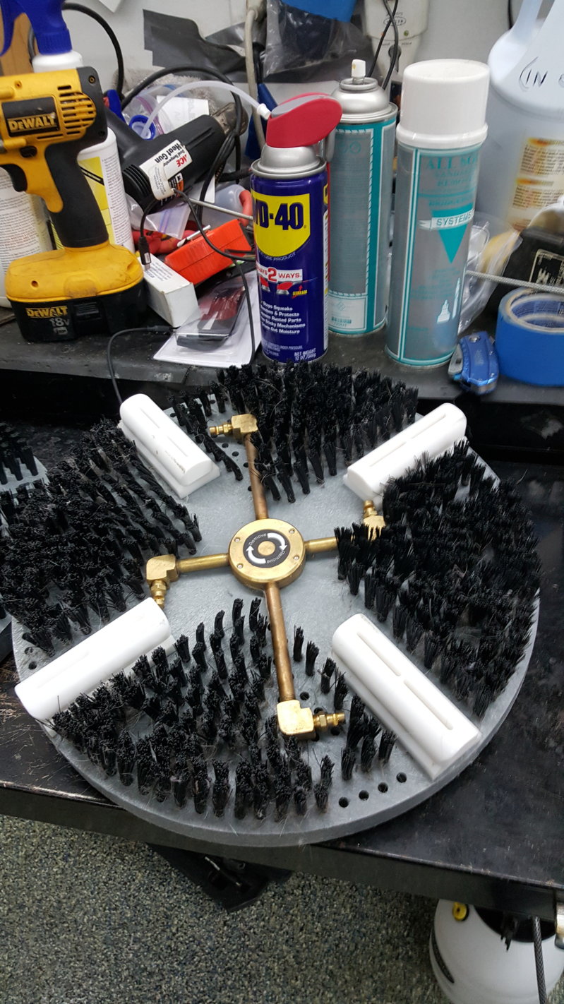

Is this the head you are talking about? Except probably with metal standard glides are typically on it....
And what kind of cleaning machine are you using with it (TM, portable, brand of unit?)

So far on the 360 XL we like them with the brush head. Metal shoes without the brush.. Have an all Teflon head getting ready to try on certain situations...

No, stick with the metal ones unless you use the brush head.... The teflon glides you lose a lot of agitation.... I have 4 OG twin head RV's, 1 RV360, 1 RV360i... I've got a set of Green Glides on the old RV360 and they get chewed up from the tackless strip... I've even got the glides for the OG RV twin heads too... Lose agitation but gain dryness...
