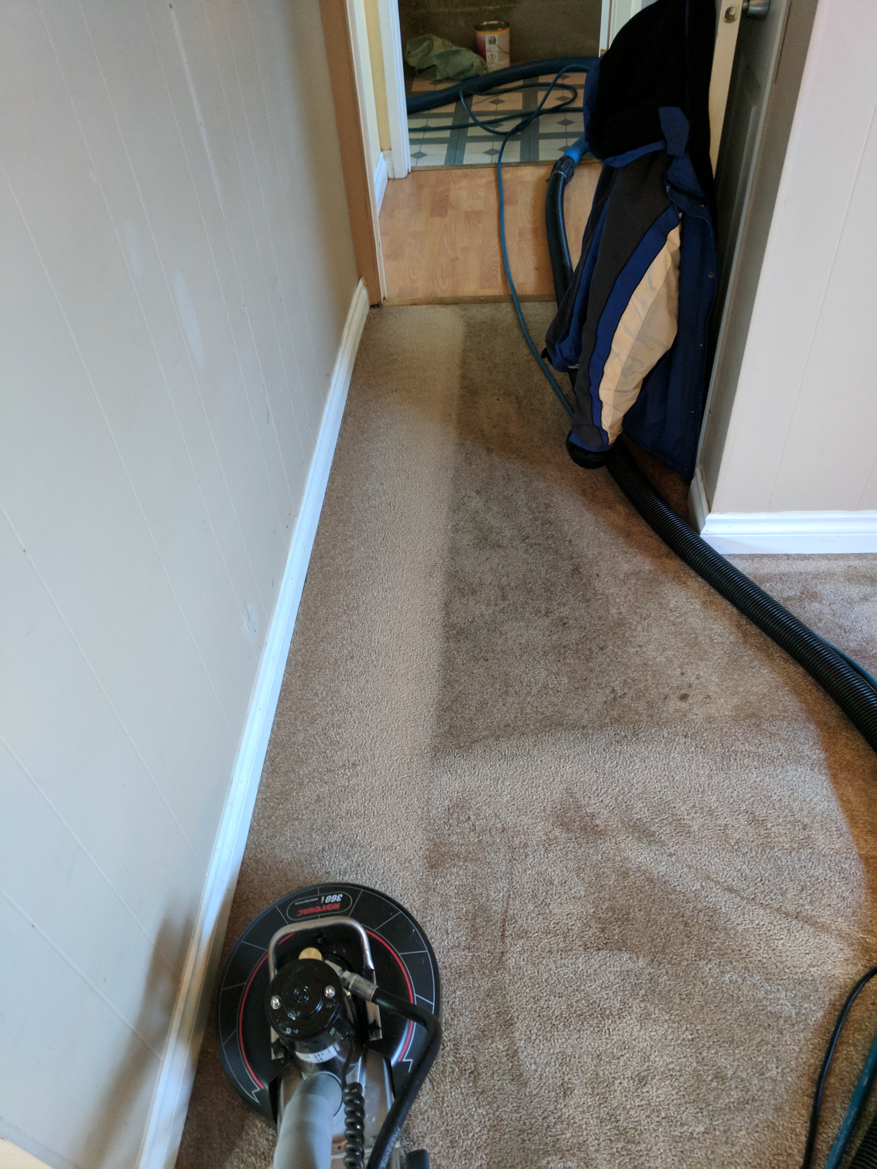

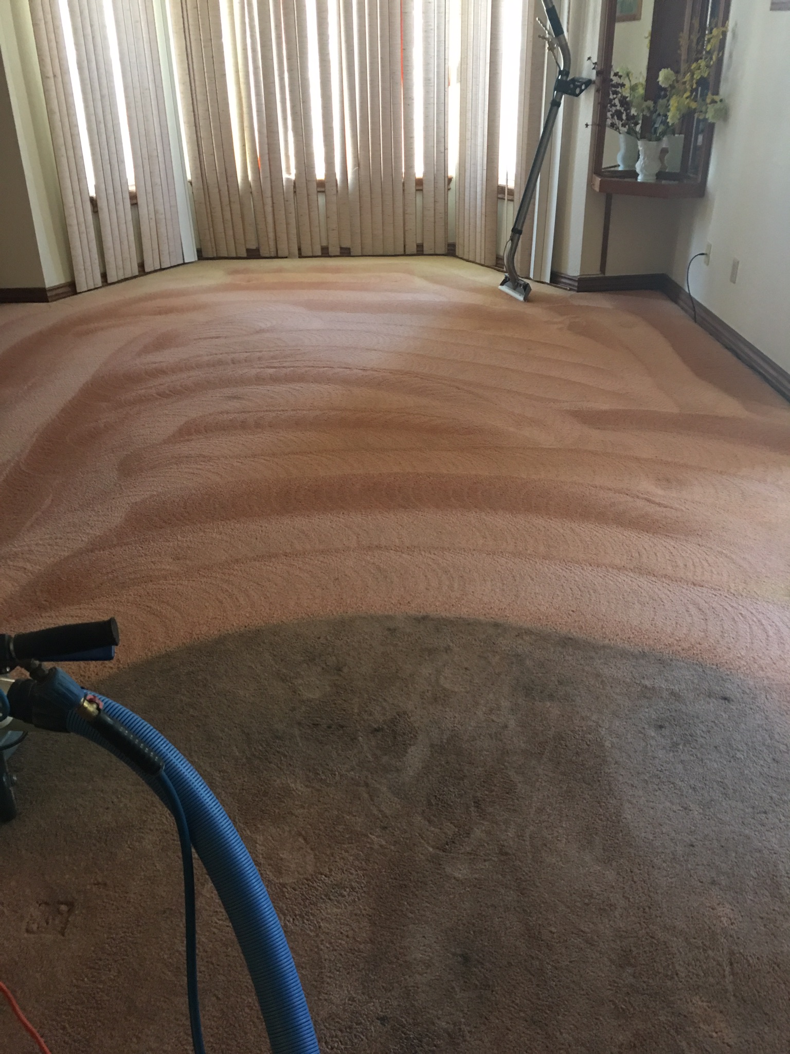

Just a little pic of what the 360 I is capable of. Loving my 360, anxiously awaiting the xl. Hopefully should be here this week.

I need to get one of those things. Looks like it would put a hurting on some dirty rental carpet.

The I is great on residential carpet but I find it jumps around a little on cgd. The xl is a little heavier, a little larger motor and when I tried it out it seemed a lot smoother on cgd. The I is light weight and easy to carry into a house or condo. It's on my truck all the time now. I don't use it on every job but when I get those nasty ones, it just rips right through them.
