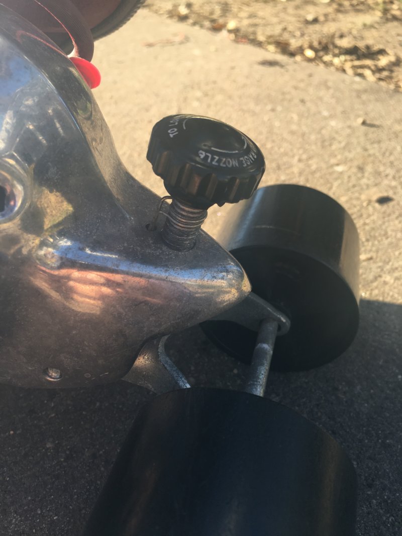

i am having a problem with the height adjustment on my royal vacuum. I will set the height with the screw knob on the back and by the time I am done vacuuming a room I have to readjust the head back down.
Is there a fix for this?

He must be using the 18" model.
It screws up and down. There's a little vacuum relief nipple that pushes in when making contact with the carpet.

I have been using Royal vacuums since 1978. I bought a brand new shiny one about three years ago. It does the same as you described. When I phoned the shop where it was purchased to get a fix for this problem, the owner was very discouraged by the new Royals...made offshore now.
The new models differ from the original design thru the use of a pin instead of the threaded adjustment screw on the originals. I have a few parts for the ogs kicking around and will modify the housing to accept the infinitely variable screw. the one precision move will be to drill a small pilot hole to accept the retainer spring that winds onto the og adjustment screw.

Take off the spring and find a nut to fit the threads. Adjust the knob where you want it and gently snug the nut down against the vacuum housing. This is called a jam nut. The only downside is you need a wrench (small pocket crescent would do) to re-adjust.
Replacing the knob may help, but may not if the threads in the housing are worn too.
Usually real jam nuts are thin, but a regular nut will work fine unless it's height prevents you from screwing the handle down as far as you want.

It won't be easy finding a new adjuster, I believe Mikey has a Royal in need of that part also, if I remember correctly. I may have one kicking around my parts collection.

Carefully unthread the spring and insert it into the body as far as it will go, then thread the adjuster in. I don't know ifthat would help, but on my old one, the spring is fully engaged.
114,519
Right one of my 12" has a eyelet screw that I put in to eeplace the missung foot adjustee.
It doesn't vibrate loose.
Try another screw or wrap some teflon tape around the threads.
