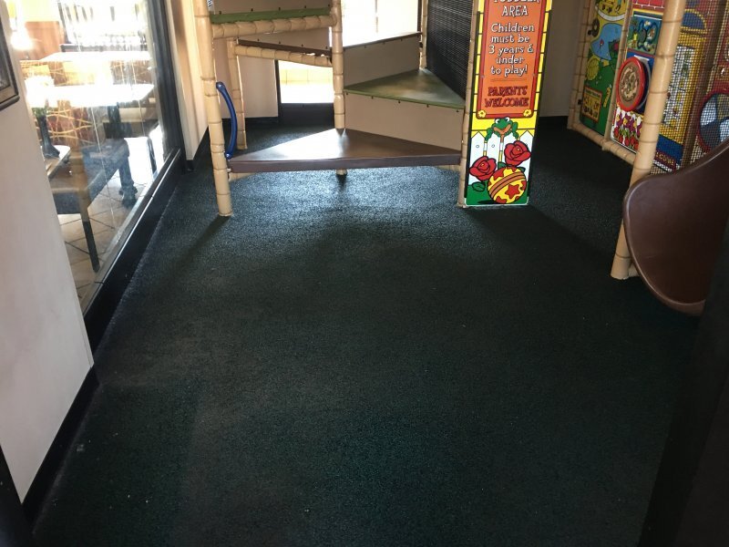

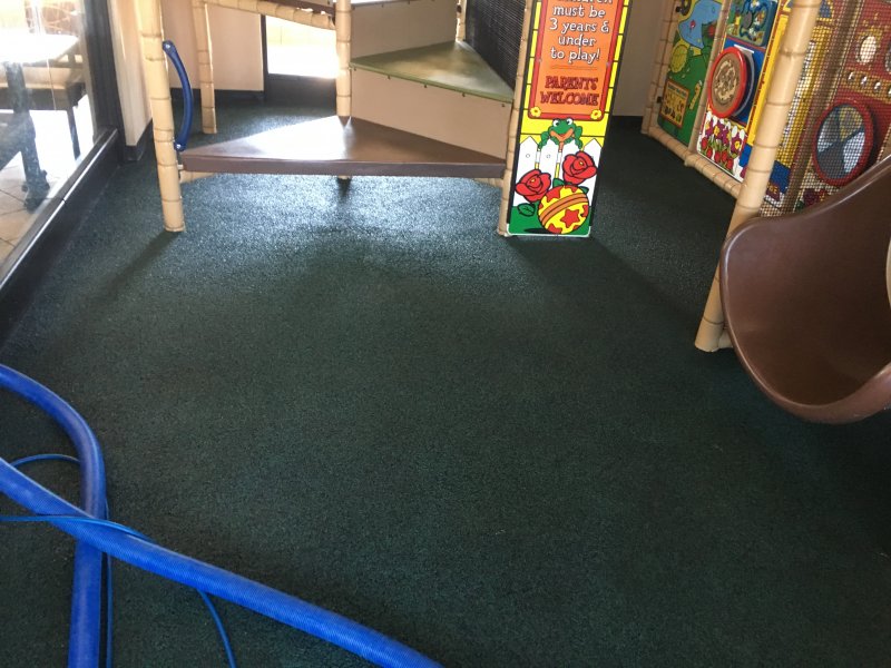

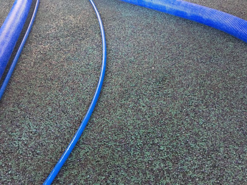

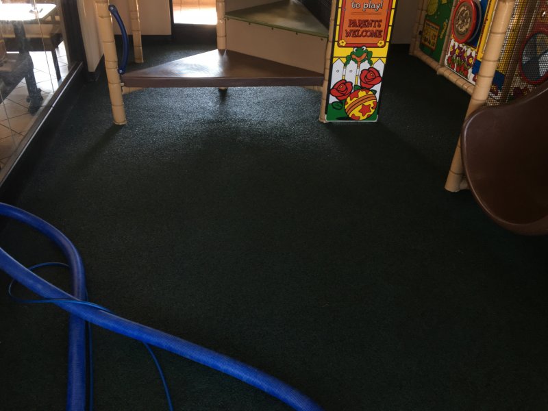

I cleaned it just like carpet, except I turned up my psi to 750. It was my first time. Has anyone ever cleaned one of these?
14,646
All those pics are what it looked like after. The change in darkness was just my flash being on and off
14,646
This was before

I did this floor again today, and found pieces of the playground floor in my filter. @Lee Stockwell , is 750psi too high for this floor? My friend @Russ Roberts told me to keep the ph at 10 or under, so I used Harvard Grime Release. I couldn't remember what I used the first time I did it.

View attachment 70464 View attachment 70465 View attachment 70466 View attachment 70464 I cleaned it just like carpet, except I turned up my psi to 750. It was my first time. Has anyone ever cleaned one of these?
I have done them.
Each situation different.
Spray and CRB scrub
Sometimes wand sometimes turbo
Depends what I need to accomplish.
One time we were trying to match up old to new tile squares. Got close but no way to make perfect.
