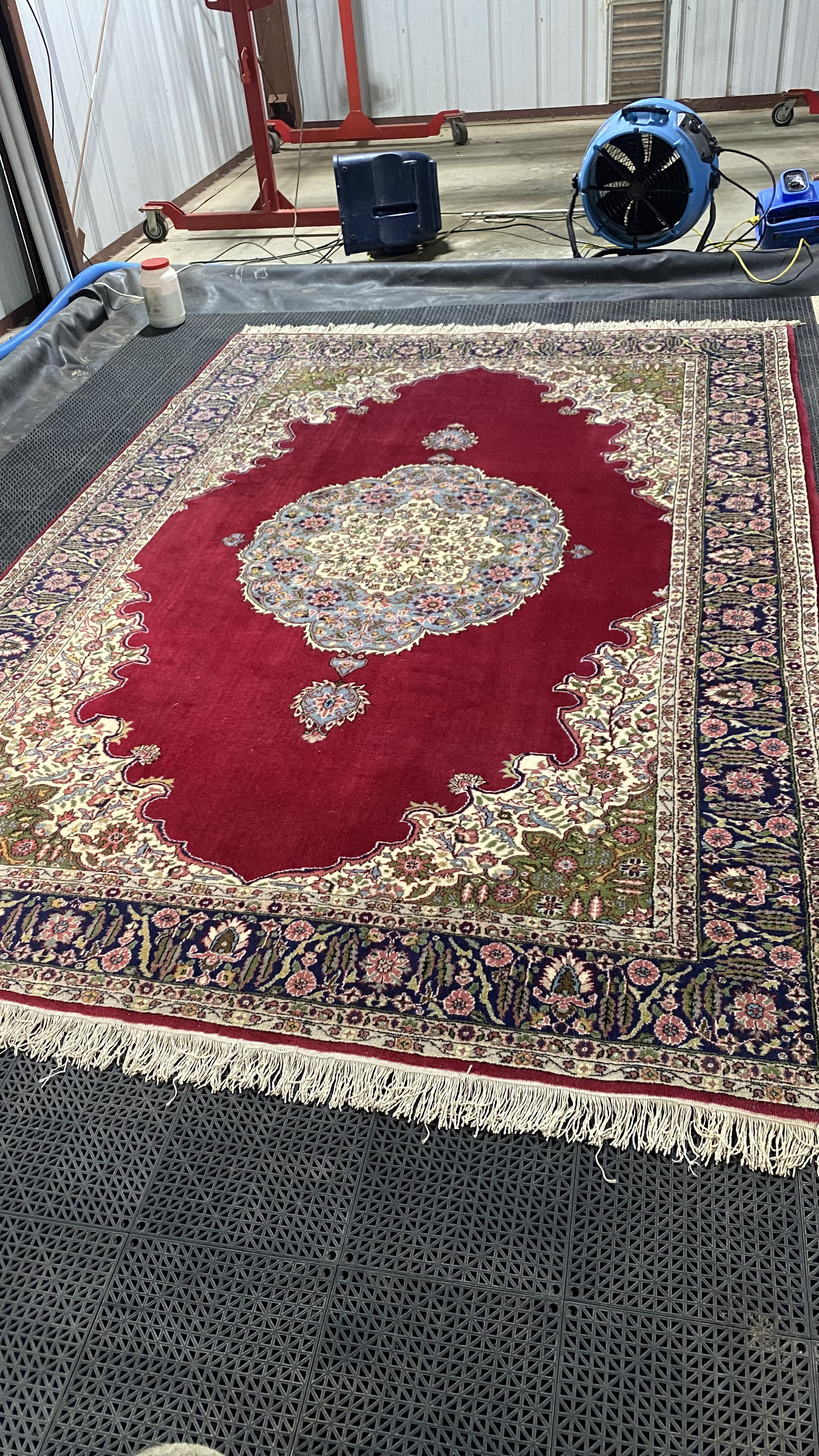

I can officially say cleaning high end rugs are a pain in the ass. Especially alone. I offer free pick up and delivery. Often times i get rugs so huge i can hardly lift them or even can’t lift them at all.
I think i'll be buying an automated rug washing machine. Seems the word has gotten out I clean rugs and that side of my business has slowly been picking up. Not sure I want to continue washing rugs unless I can get some automated equipment going.
