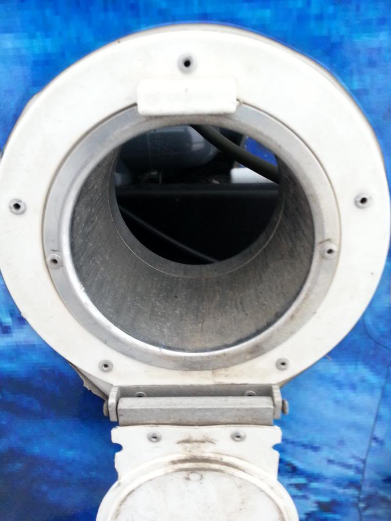

Going off the picture on the 1200 it has the same vacuum port and about in the same location...turn it and re-plumb it out one of the back barn doors.......

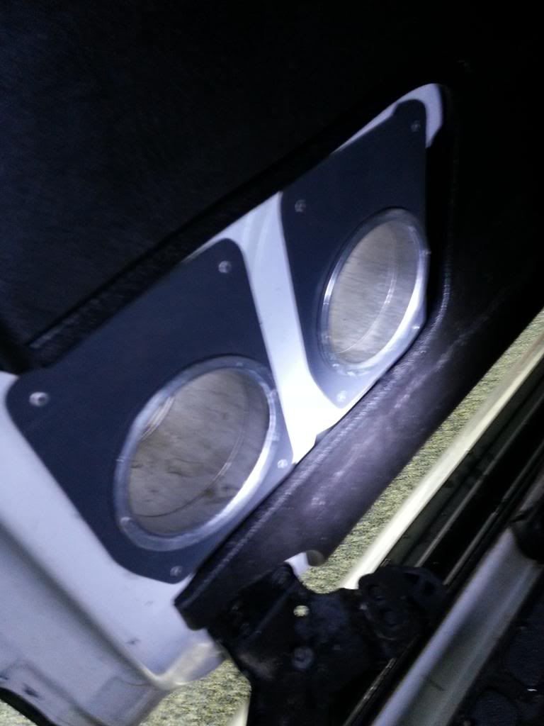

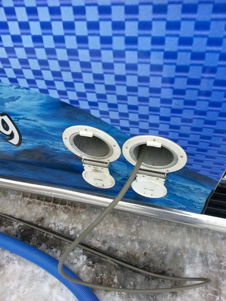

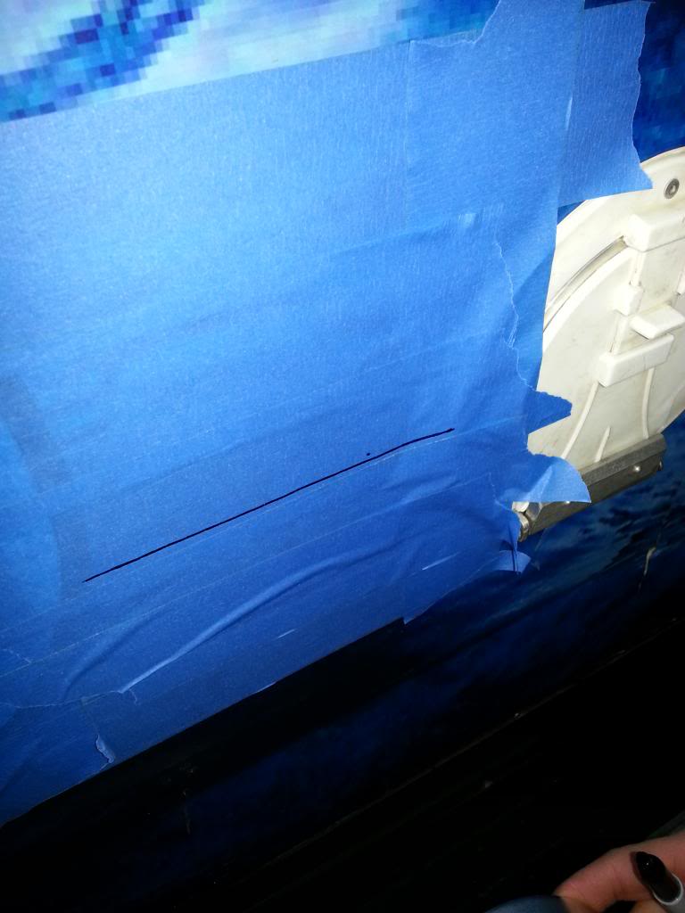

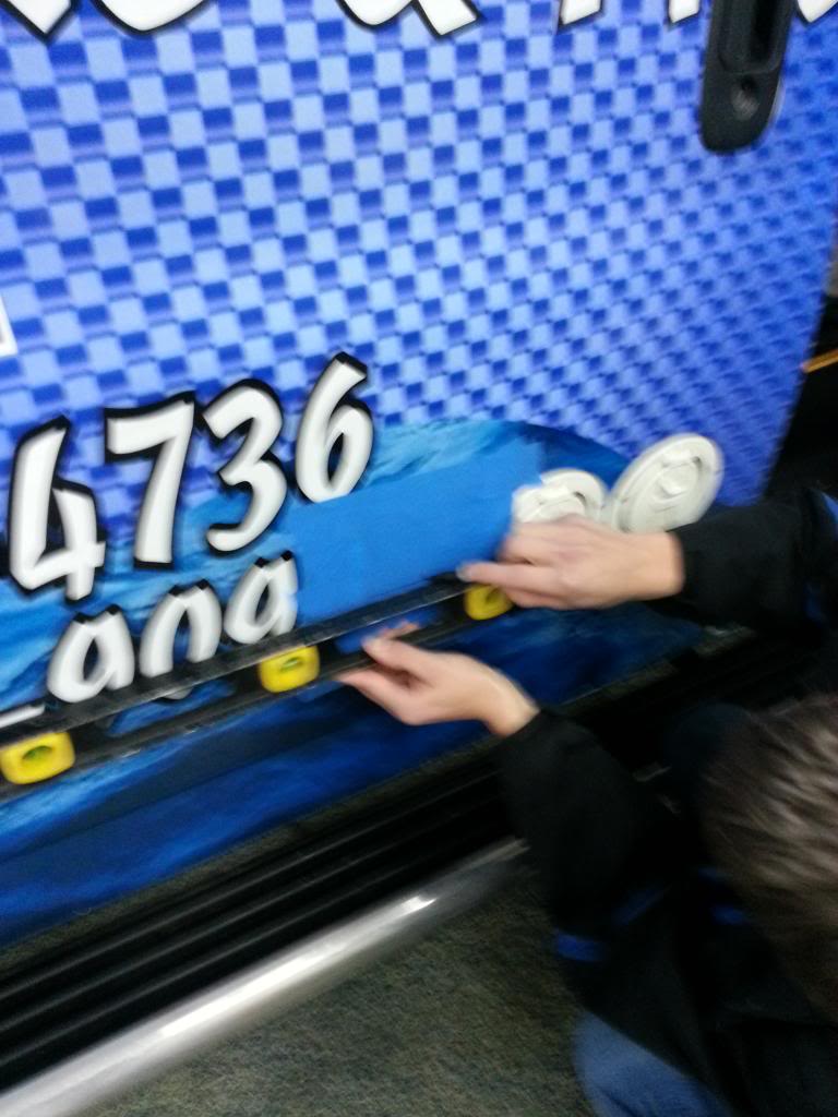

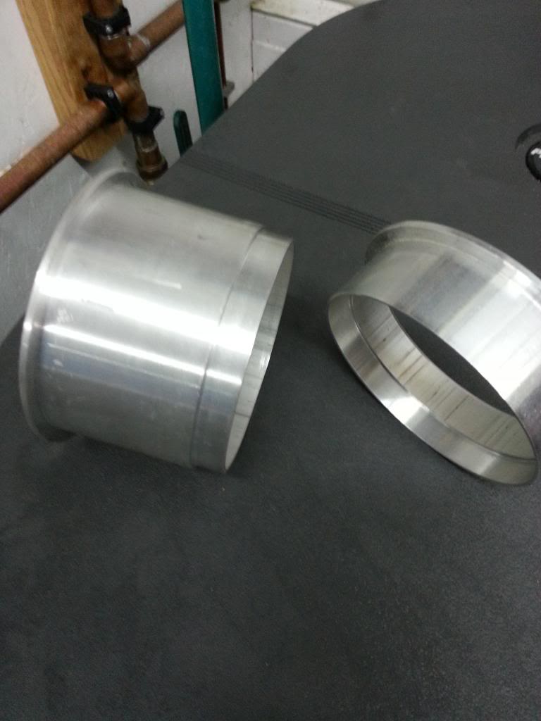

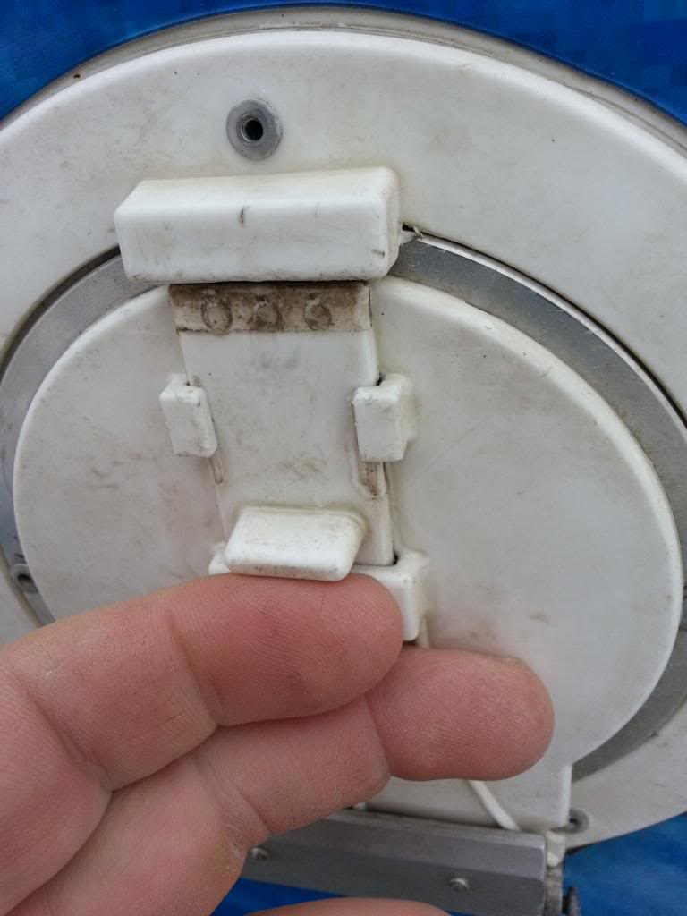

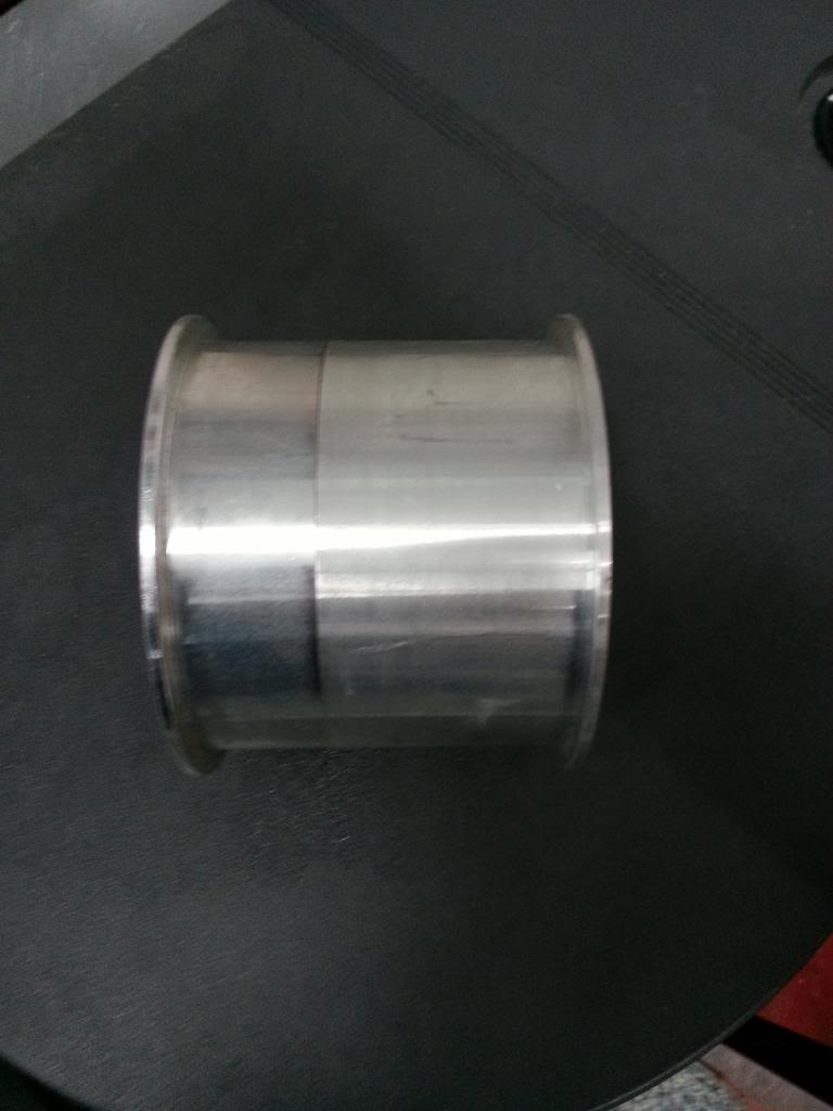

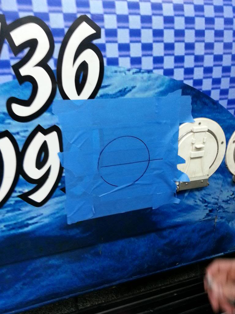

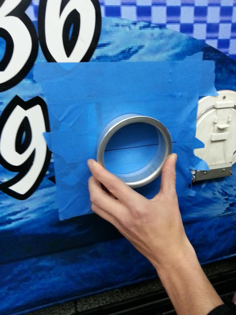

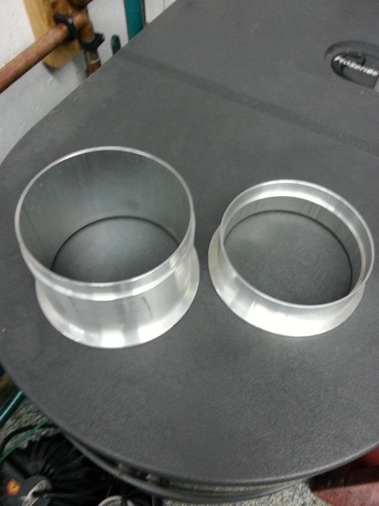

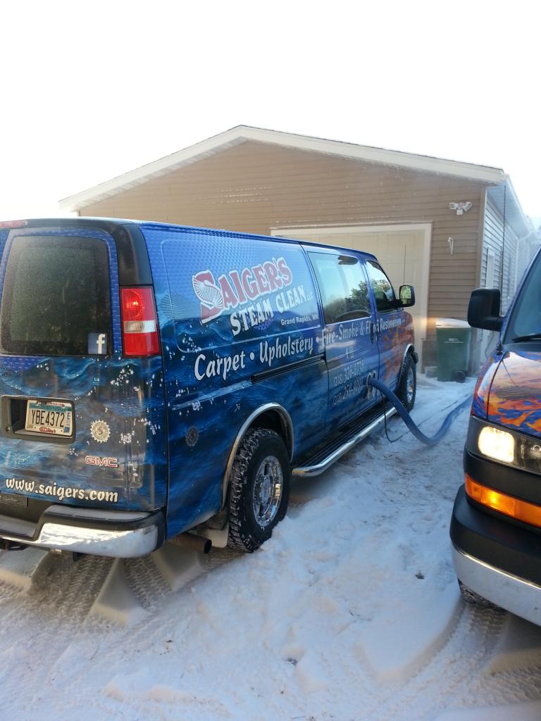

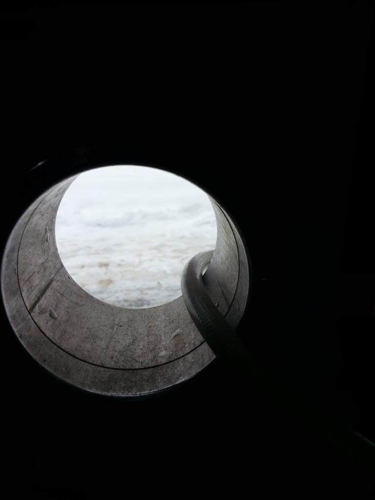

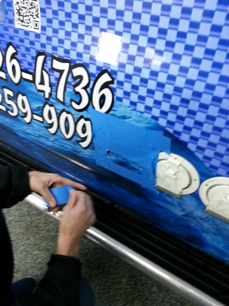

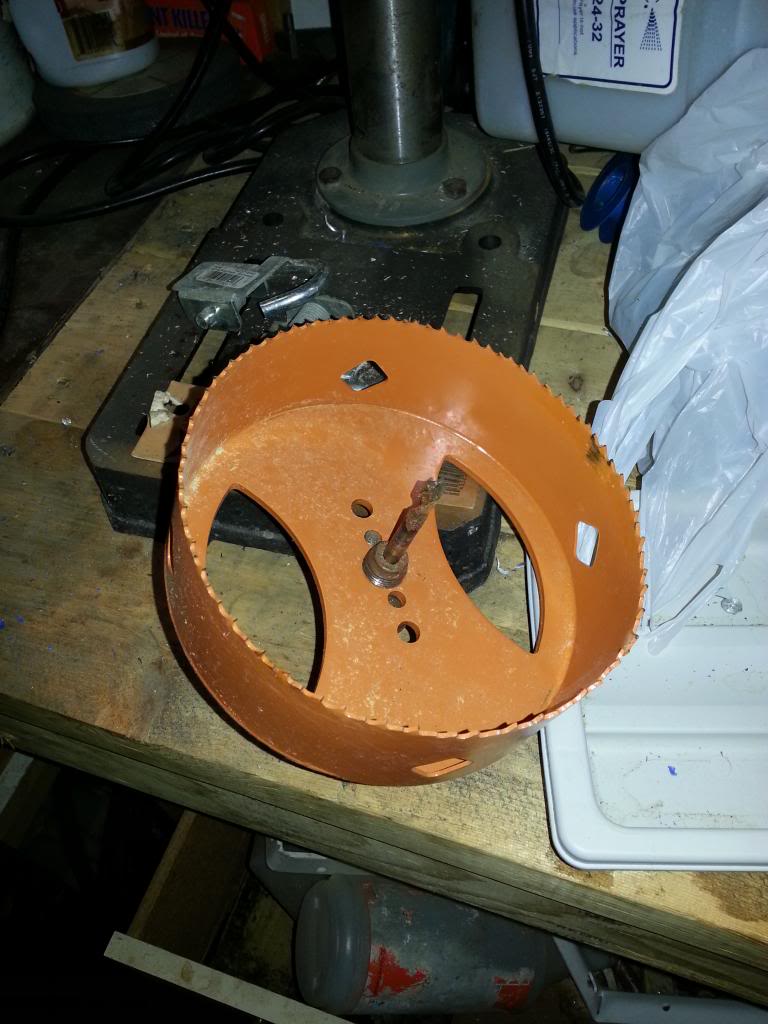

  • Mark, that is very neat and thanks for the pictures. Is opening or closing while hose in create any issue? What's the distance from door to where hookup is?

Put a loop on a section of vacuum hose that connects from the tank to the door opening. Long enough that the door can be opened completely while still hooked up, short enough that an elastic cord can lift up the slack when it is closed and running.

Hopefully you just got a chance to see the videos posted (while you were both posting your threads)
The videos will maybe help with all the ideas mentioned.
Mark

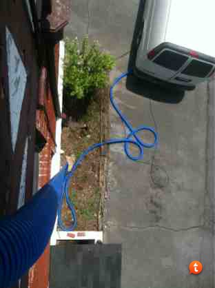

yours is right where mine on the 570 is...its a tight fit...and I am not sure you going to get enough bend out of a hose to go into a port hole and still have a moving sliding door....if you manage to get a bend in it then I would put a travel loop in the hose so it can roll with the door.............

a circle......hook to the vacuum port....run hose hose down the floor put about a 2 foot circle in it and put it threw the hole.......wala...a travel loop........it will move the hose freely with the door and nothing will bind up........
