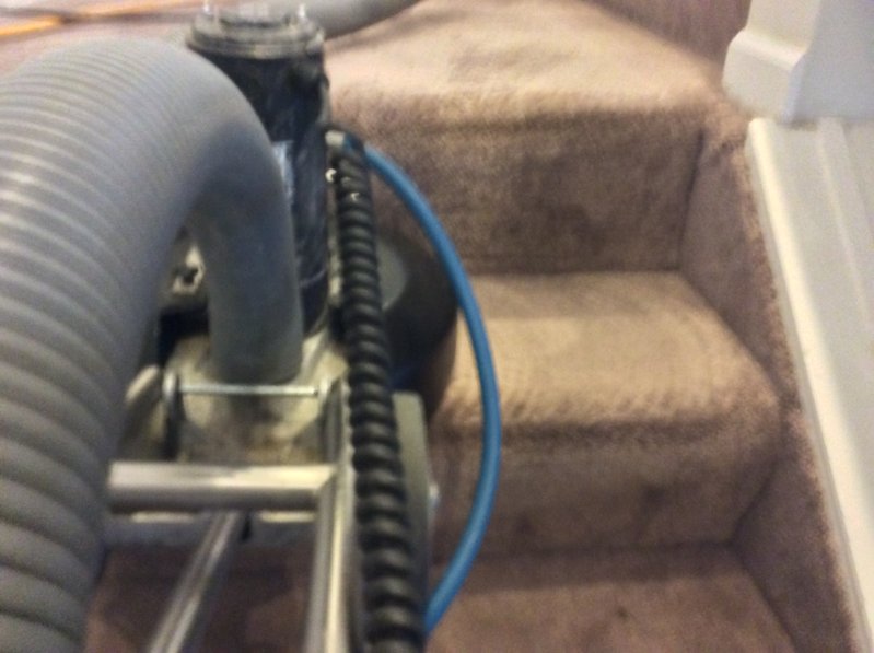

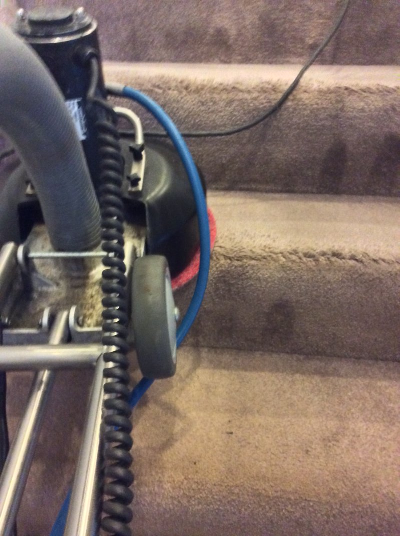

The 12" head sprays over the edge of the 11" stair step, but you are going down anyways so you vac up that overspray. A badly trashed step will get two or three slow clean passes then two or three dry passes. This really leaves the stairs practically dry. At the bottom of the staircase you have a towel spread out to catch the overspray from the last two steps. It can take up to ten minutes of running the RV to clean a trashed stairway. The nice thing about the 360i over the Trex Jr. (which would also work well) is that you collapse the handle to make a short tool. You flatten the handle at the top of the stairs and as you approach the final 3-4 steps you gradually raise the handle and can even work in the 45 degree position if necessary if you are in a tight area with the wall at your back. Watch for overspray off the side if the staircase has an open right side. Things under the right side of an open staircase should be tarped or moved out of the way..

The small stair head for the 360i is VERY aggressive. I've used mine about twice. It's very hard and even a little sharp on the edges of the metal "glides".

I'm getting pretty quick with this new CRB. Don't even have to change the handle now. It takes me almost the same amount of time to scrub and do the stairs as it did when I did it just with the wand and went over them slowly.

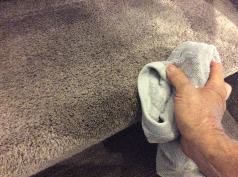

Prerspray,red pad (optional),swoop head, wand, towel dry bull nose.

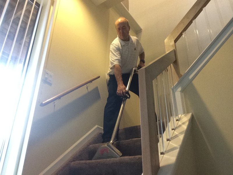

Prespray the stairs......use a scrub brush for the nose and use your stair tool.

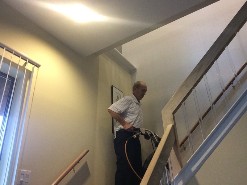

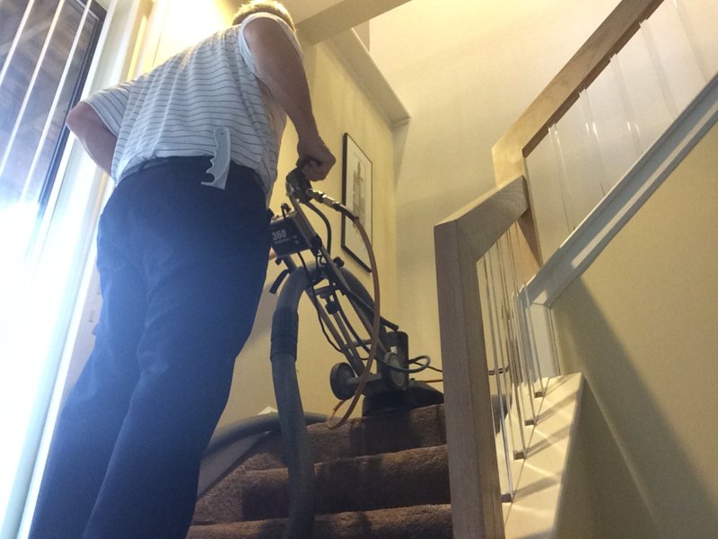

It's quite effortless to use the RV as opposed to scrubbing with a brush and trying to achieve the level of clean with a wand on a very heavily soiled stairway. All you are doing is balancing a floor machine which anyone can do with a little practice. If it's really bad it takes about 10 minutes to rotary clean a flight of stairs. You are scrubbing and steaming all in one step.

We use the 360I quad head for the stairs, once done we use a swivel stair tool to edge and detail. Not done in 10 minutes but the stairs look great when we are done
Ps Use a bar of fels for the nose after prespray.

I've timed it many times, that's going slow with the RV. Then yes, a quick dry vac with the wand going down, and a quick steam up the riser. Effortwise, on a trashed stairway, it's easier than hand scrubbing and slowly
wanding to still not get the results of rotary cleanin. Same as traffic lanes in a room; if you tried to hand scrub and wand you would have no where then results of a RE. You know that. And stairs are often the worst traffic lanes in a house.
