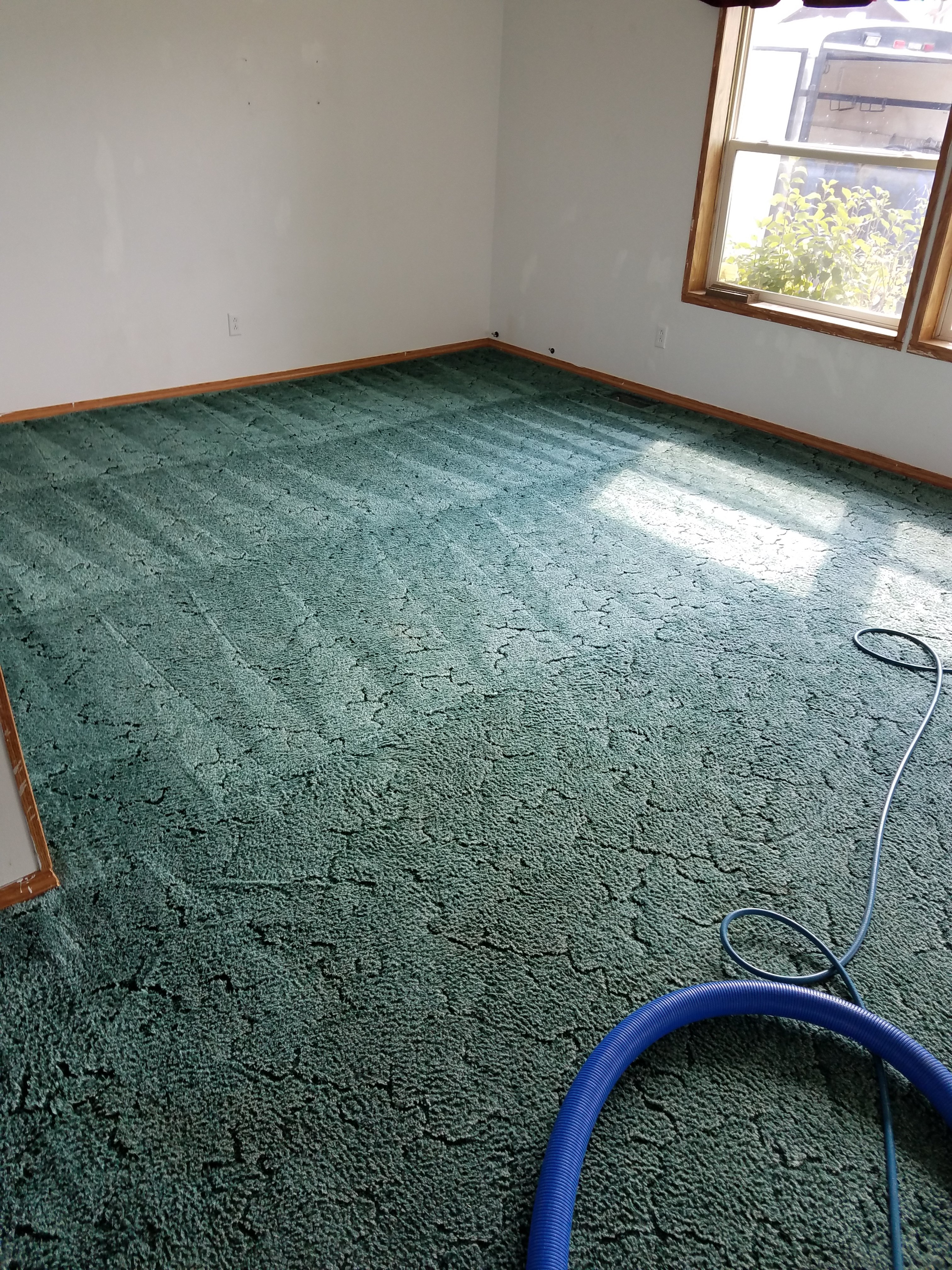

Tom. Thank you so much for stopping by that Job and letting me test out your new wand. It makes my DevPro #3 seem like a crop duster and the new one is a Lear jet. I do love my current wand, but will surly be getting the newer one at some point. I had no idea what I was missing. It was like pushing a cloud.
