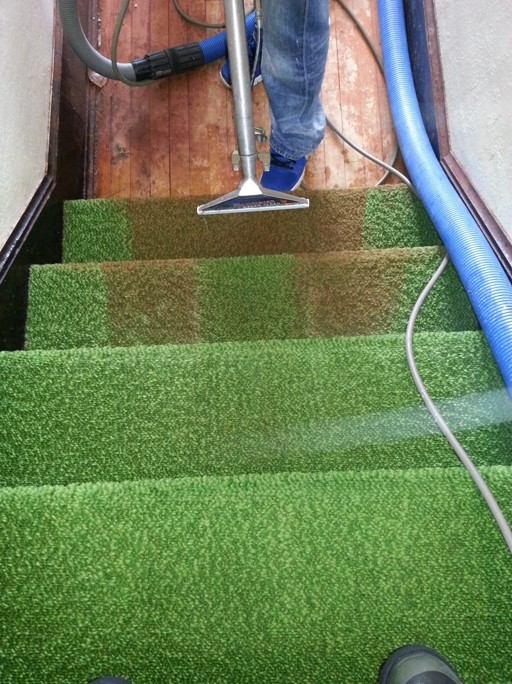

Citrazov great product and came out about a year ago....
Saiger Sauce we have been using 7 years to address iron ore type soils originally that are in our area, then tweaked it for more uses so prespray is ready for many situations...
Citrazov powder also just refined a bit more in late October...has a better scent now as well as slight formula change...
This is a serious case of iron ore soils in our area.
With full extraction and rinse we have not had an resoil issue, or if it was happening....we would not be using it....
