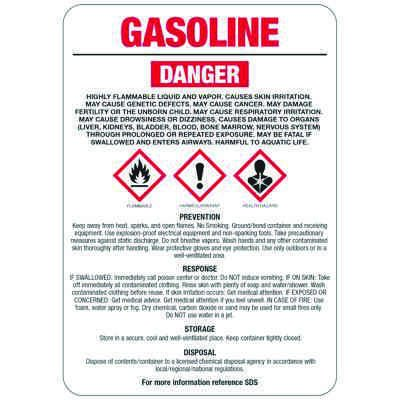

Fred, that link on the JD site (on the Super Sealer page) pulls up the SDS for Saiger's Deep Blue Extraction Rinse instead.
I just missed the "SDS" on the Saiger site.
Forget what I said about "should be safe" even if the product is fine, we have to consider OSHA regs. Owner Ops don't have to worry about OSHA, but this symbol on the Super Sealer SDS makes the product a no-go for us:
