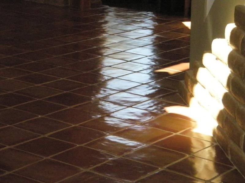

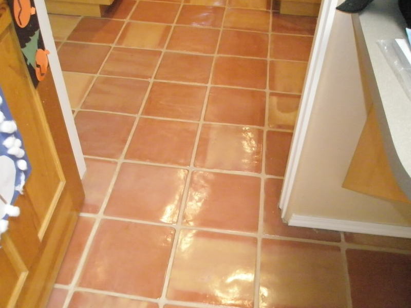

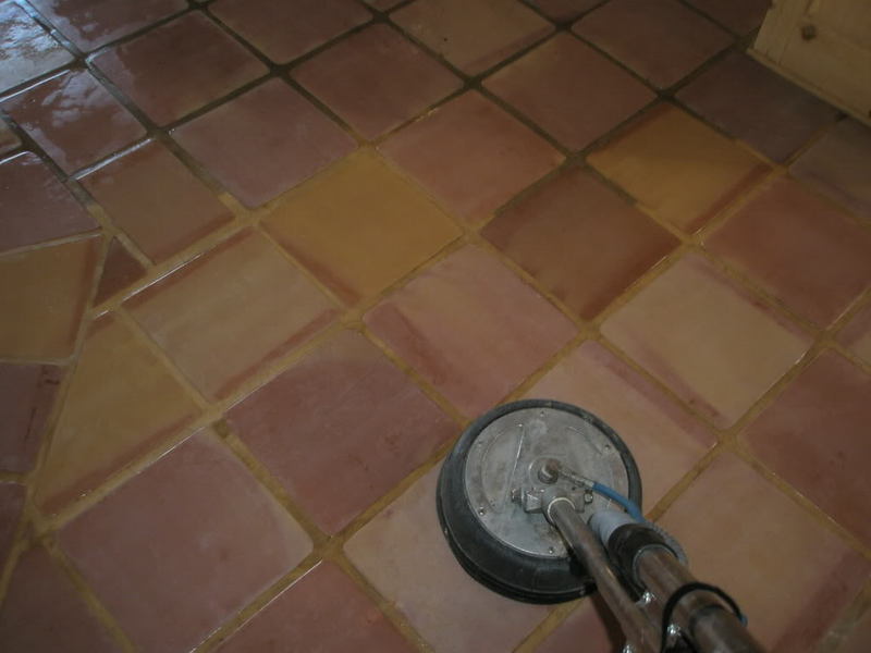

1 strip with harvards 710 rinse with straight water and finish with quantum concrete finish
I get a min of 450 to start a small kitchen and just cave a est for 1500 sq ft for 3500$$ it will be a short 2 days one for strip and one for 4 coats of finish
R
Ron Lippold
why? no one wants to do these. Its good money and with the concrete finish I have floors in art gallerys that have almost 2 years and the finish looks cherry
