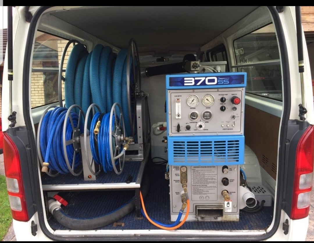

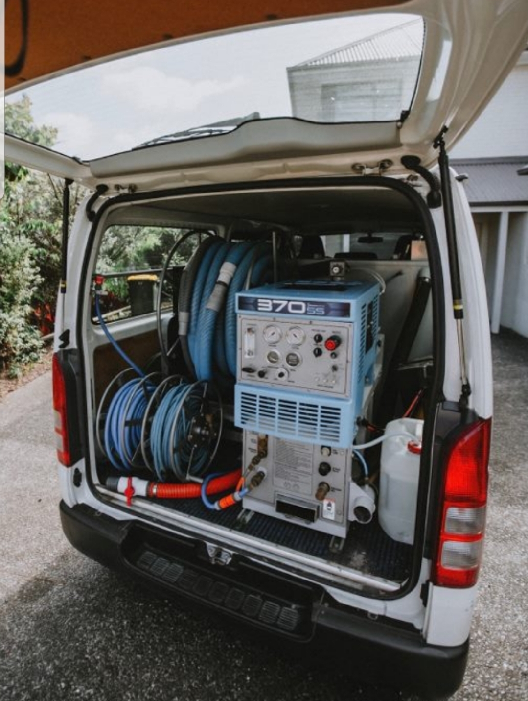

Dan
They're all out the back down here, haven't seen any sidemounts..
