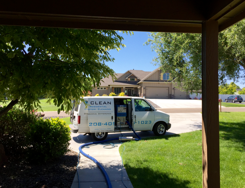

Roll call, How are your 370's holding up? Mine has been excellent but today I was doing a flood extraction with the pump OFF and the temp was reading 280. I hooked up water and cooled her down so it wasn't a problem and my Bimba is working fine. It was close to 100 degrees outside today. I have around 825 hours own it (took 2 months off when my mother died ) Over all I am impressed with the machine and it's holding 200-225 with 500 psi 7.5 flow in the summer. The vacuum is excellent. It's a tough little SOB

Nice looking little unit Todd. I really like those safari/astro vans. I just sold one with my back up unit and am starting to regret it. I wonder if you need a manual diverter valve to completely by pass the heat exchanger when doing flood extraction work?
14,632
I don't care what truck mount you have...if you have the water turned off, and are running that rig wide open during water extraction, something's gonna get hot. Even if the manufacturer says it can be operated with the water off, I still leave it on and I tap it open, letting cold water slowly drain through the system.

It's an 04 Astro 4.3 liter V6 Vortec with 110k on it so parts are common although I haven't needed any parts yet since I bought it for $7k 6+ years ago, besides an alignment and tires. I added air bags to the rear suspension also
And yes I can just bleed some water through when doing flood extraction so it's not to big of a deal, Thanks.

On the Sapphire unit unless you turn the heat on the diverter remains off. Still the blower will heat the water box and it will get hot but plugging water in and opening bypass a crack will keep it cool.

Yes the heat was OFF and the diverter was in the proper location. The machine stays HOT in the summer while cleaning too. I love it. I am going to turn the vacuum down to 14. It was set @ 15 at the machine but my hose cuffs leak a little so it never goes about 13 or so when cleaning. Yesterday it was holding 195 on low but it was close to 100 degrees outside. It is a hot little machine in the summer but could use a little more heat in the Idaho winter. I keep thinking about buying a bigger machine but I don't really need anything bigger for what I am doing. 100-150 ft max. I can clean most 4000 sq. ft houses with 150 ft. I don't do much commercial work. Hate the hours !!!
