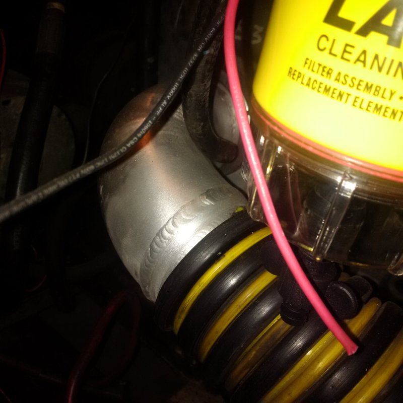

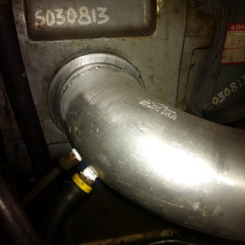

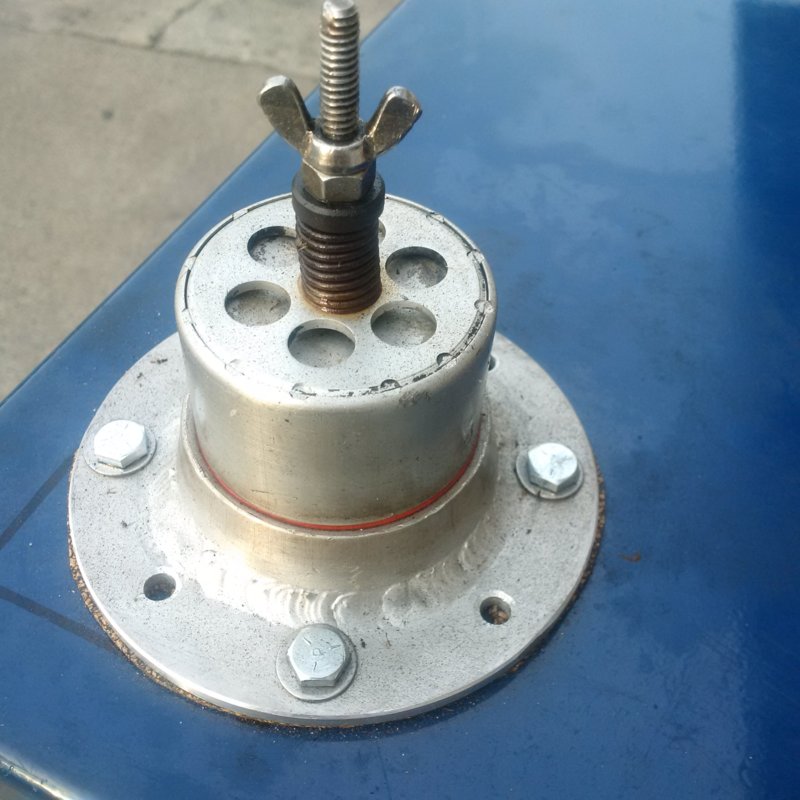

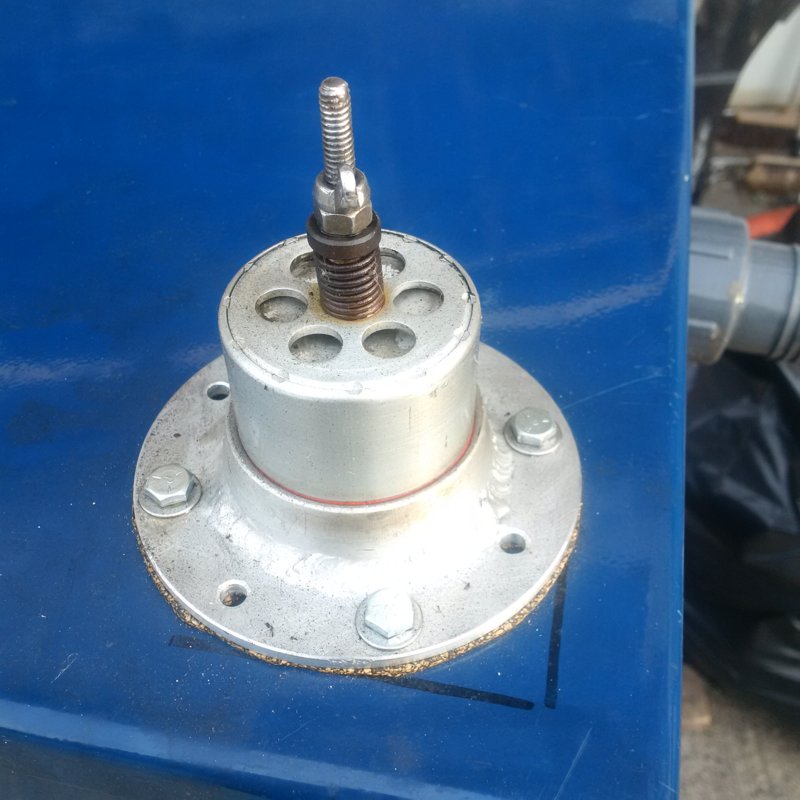

One thing you can do to improve your vacuum. On a lot of mastermatics, the vacuum relief valve is mounted on a t coming from the blower. This cause turbulence in the airflow and if the valve breaks, pieces will damage your blower. We replaced that fitting with a stainless steel stretched 45 degree elbow going directly to the waste tank and relocated the vacuum relief valve on the waste directly. Will help to maximize your vacuum and air flow.

Could you send a picture of this?
28,088
I don't have any pics of the old set up but I will take pics of the way it is now.

Most of my tm's have the vac rel. Mounted on the waste tank. My neighbor is a fabricator and engineering genius. The moment he saw this old mastermatic he started coming up with ideas on how to improve it. I recently sold another mastermatic that I had converted to propane (not as hot) but used the same vac system and the vacuum was incredible compared to the way it was originally. We had trouble with the wand locking down on the carpet so we had to reduce the vacuum to 12 inch hg. I should have this one up and running in a week or so, with that 220,000 btu heater. Do you run your on kero or diesel?
