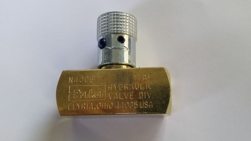

You will want to call Windtrax and order one of these..
Yes, it locks. With an Allen key.

Is that the same valve we all put on our Hoss's. I'm not near my machine to check

Mikey;
We used that same valve years ago on our portable 13 HP TM.
It was OK, but it will rust internally, since it is made for hydraulic fluid.
We have a better non-corrosive metering valve that we use on the TRex.
Larry

Mikey;
Larry
you talking about this one...
I have worked with this type before....they have a very short life when it comes to high pressure.....
The kind we have last a very long time....never ever have I had one rust.....
BTW...how long before that 45 screwed into the valve gives out...there is no way that all that weight from that swivel ( damn nice swivel I may add )....and all that brass..is not going to snap that thing at the threads...........
just a heads up if this is how they are being made...someone might want to change it.........
you don't need a swivel there...just pipe it straight out.........
