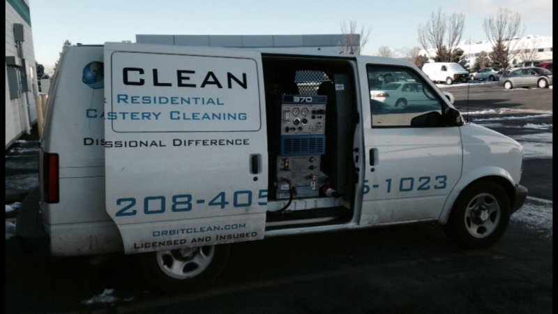

I'm loving it so far. I've only put about 10 hours on it. It's an awesome little machine. I have the APO with it too. It's hard to compare to the Blazer with Propane heat.

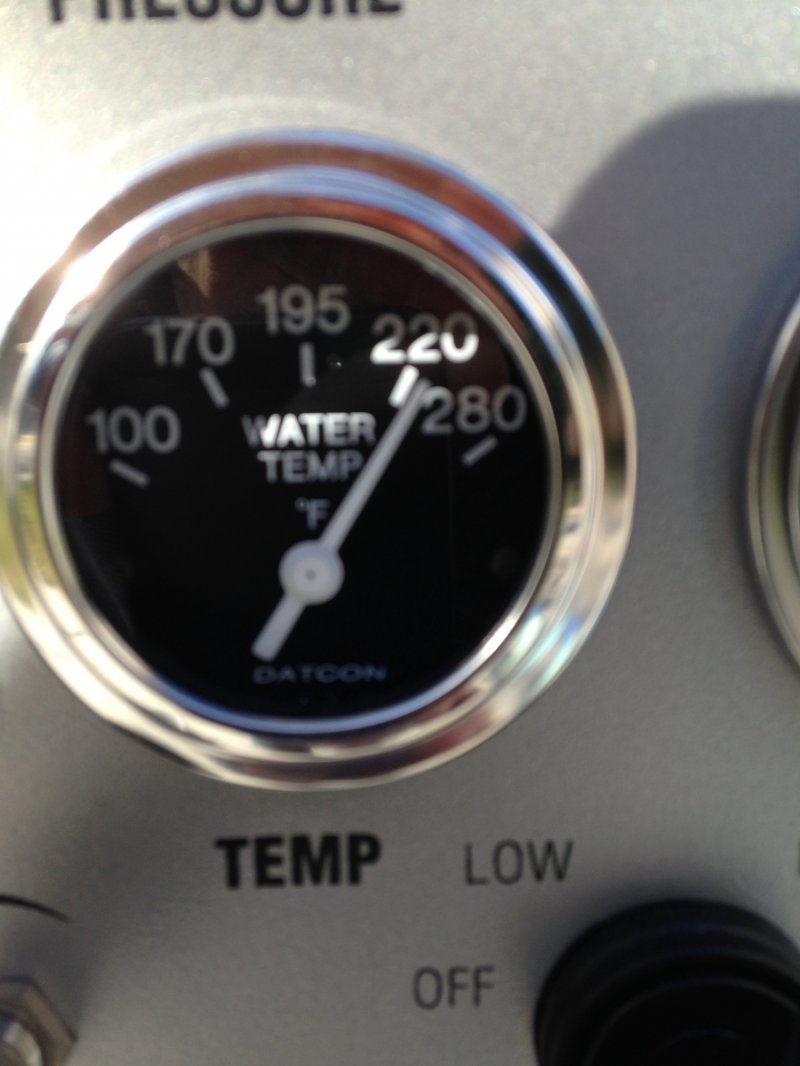

I would say the Blazer @75'probably feels like the 370 @150' but the Blazer Still cleaned good up to 150'. The heat has been good staying around 185-220 while cleaning 6 flow Prochem Quad Jet and around 50 degrees outside.

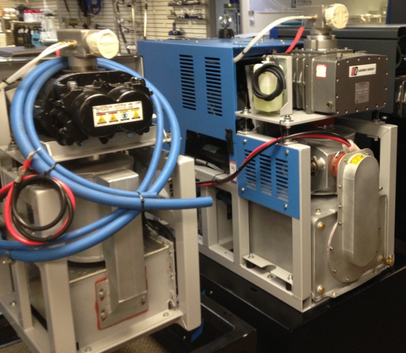

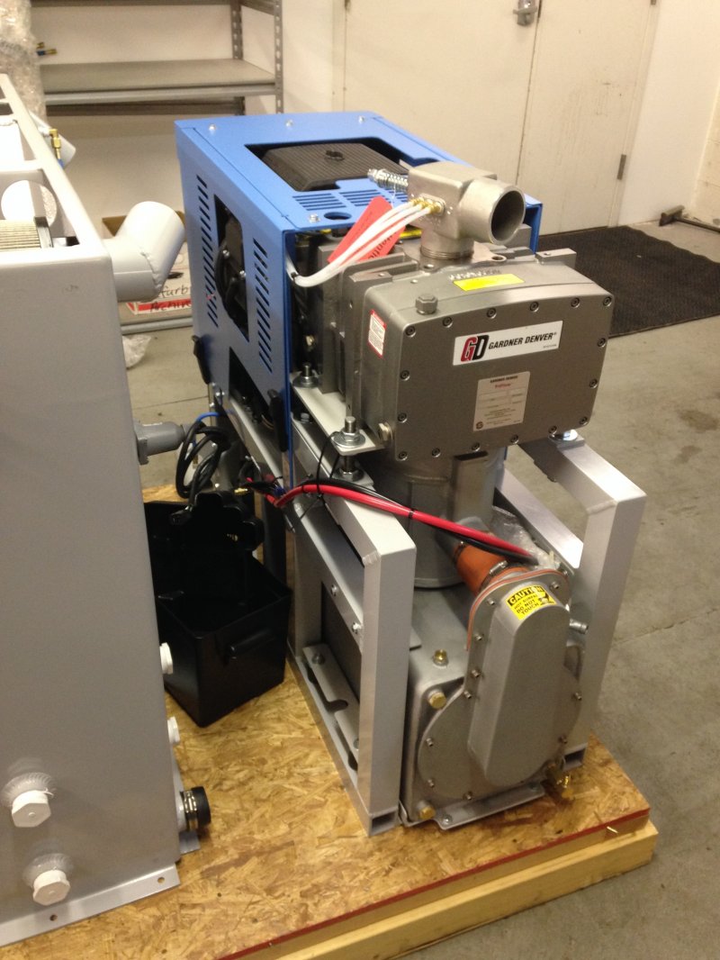

I didn't get a chance to compare them side by side but the 370 vacuum is definitely stronger. The air hollowing through the wand is much louder. I might need to think about ear plugs. the furthest I have ran is 150' so far around the back of the house and downstairs finished basement. The vacuum felt like it was still at full power and fast rise time. The machine sounds awesome too. Plus it sounds like it's running on medium compared to my Blazer. Motor runs 2800 RPM's the blower spins close to 3400 rpm's

I bought it from Interlink Salt Lake. They offered the best trade for my Blazer and made everything easy. They did an excellent job on the install too. I wanted to get a PEAK but then I would need a new van.This is the best machine for my Astro. I have more room then I did with the Blazer.

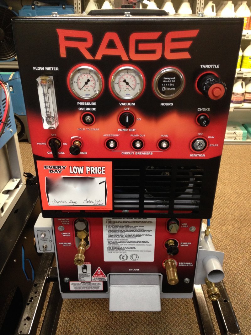

I was looking at the machines hose diagram that Sapphire publishes. Can anyone explain in real simple terms how this machine regulates the heated water? Pretty sure it doesn't have bypass valve like my white magic.

It looks like the Rage doesn't regulate the temperature per se - it has a temperature switch that operates a dump solenoid. If the temperature gets too high the solenoid valve opens and dumps water to the waste tank until the water cools back down to normal operating range.
In addition, there is a manual bypass valve that can be opened a little for low-flow conditions, such as upholstery cleaning. This continuously dumps a little water to waste to keep the total flow up (and the water from getting too hot).
The manual bypass valve is also kept open a little when flood extracting, to keep some flow through the pump. The manual valve isn't used during normal cleaning.

On the new ones the pump is on a electric clutch so you can shut it off during flood extraction.
