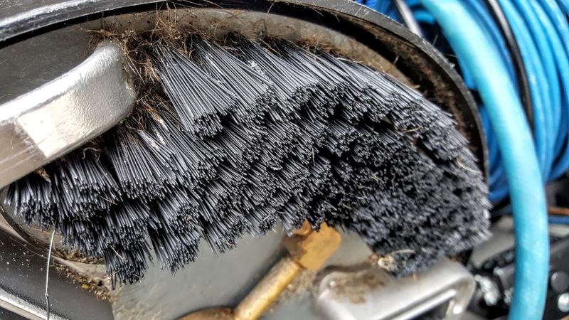

Looking at the heads I have some questions:
  1. The brush is relatively soft. Traditionally brushes need to be broken on concrete, but these are a lot softer than the ones I did in the past. So is it a must?
  2. The brush head with metal shoes will definitely provide more agitation. Is the combo (assuming the brush is broken) be enough to cause damage to a run of the mill carpet? (not wool or one of the new super soft synthetics.)
  3. Should the brush head be used only with Teflon?
  4. Looking at the Teflon versus metal shoes- the teflon vacuum slots are so much narrower. In addition to not pick up stuff from the carpet, it seems like the carpet will require more drying passes well. Is that your experience.
  5. And one more simpleton question- When done cleaning, do you transport the RV with cleaning head attached or off?

Yes, it needs to broken in on carpet.
I wanted to throw mine in a river the first time I used it. Now it works really good.

Wet it out Marty, crb it then use your hottest machine to reset the nap.
117,061
For the twentieth time..
Take the shoes off and scrub some rough concrete for 44.7 minutes
117,061
depends on your elevation to humidity to stupidity ratio
Keep the grout wet and go until the bristles are laying over..

Still a fan of the Teflon Glides over the metal.
Gives good agitation and have not seen it as a fiber distorter
And forgiving if you screw up around a transition strip or tile, etc...
