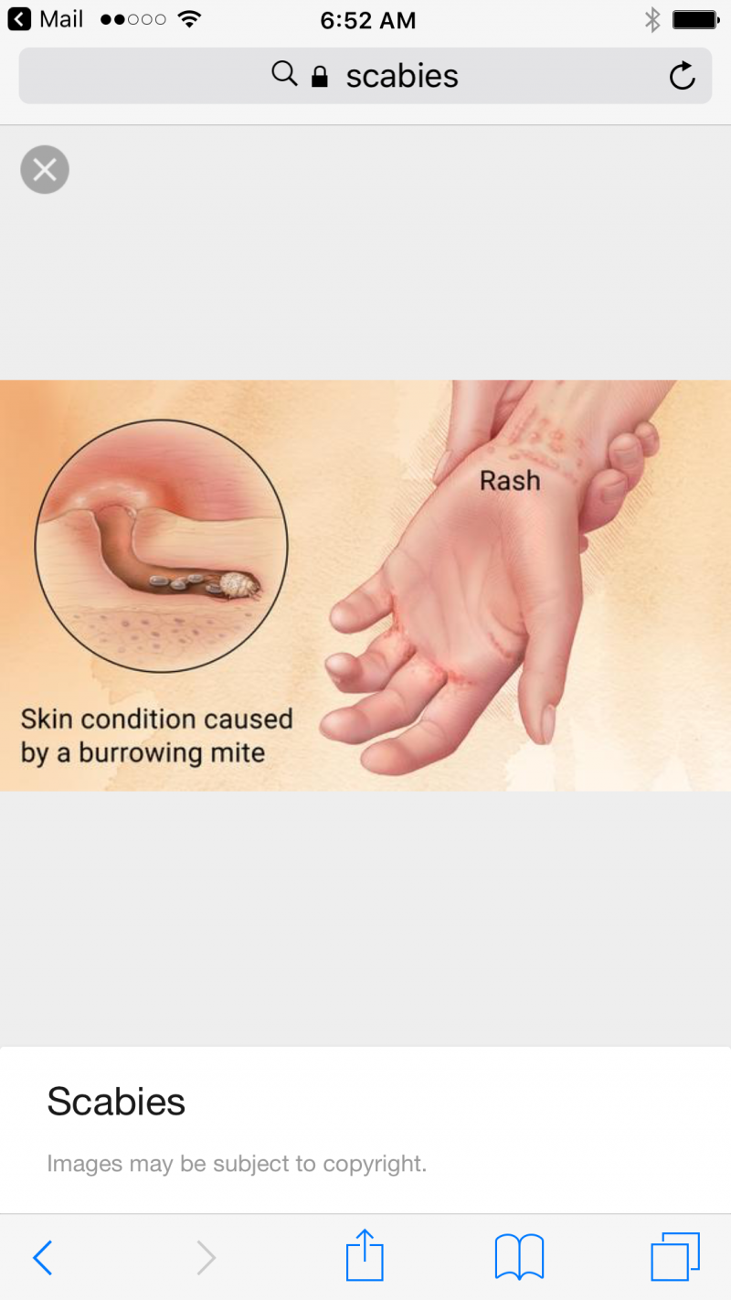

My customer at a kids clinic called today, scheduling a day to clean carpet and furniture there at the clinic. Is there anything I need to do to protect myself? And what is Scabies? It sounds like it'd hurt.
14,414
My wife just told me that the office needs to be closed for 3days so they'll die, not having any flesh to feed on
Anyone else heard that.

Scabies is sort of like chiggers. It's little bugs that gets under your skin. A little cream will clear it right up. My daughter had it when we picked her up from the orphanage in China.
