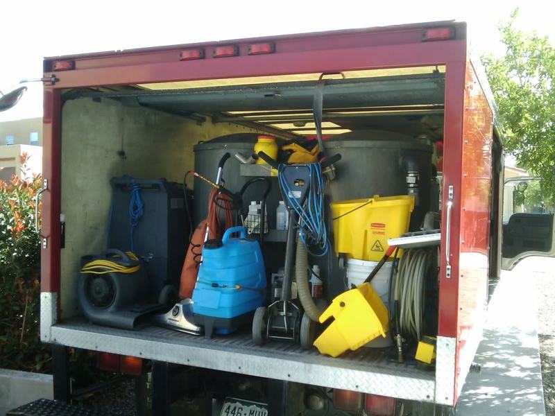

Flew to denver last week on 12 hour notice for a smoking deal on this 1999 Vortex 777. It has 105k miles and 5k hours. Everything works including A/C. The seller was asking 11k but dropped his price to 8k cash. So, i hopped the first jet to denver and drove her home with title in hand.

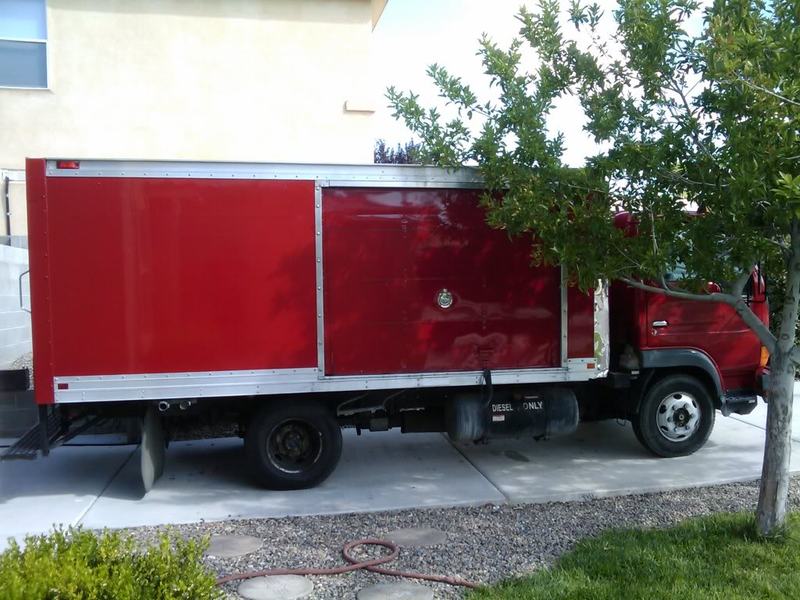

Truck looks to be in great shape!

wow...that's a great deal...it seems like i've seen that unit for sale before...but for like 16K(if the same)...so you got a awesome deal. congrats!!!

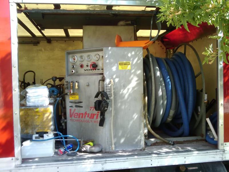

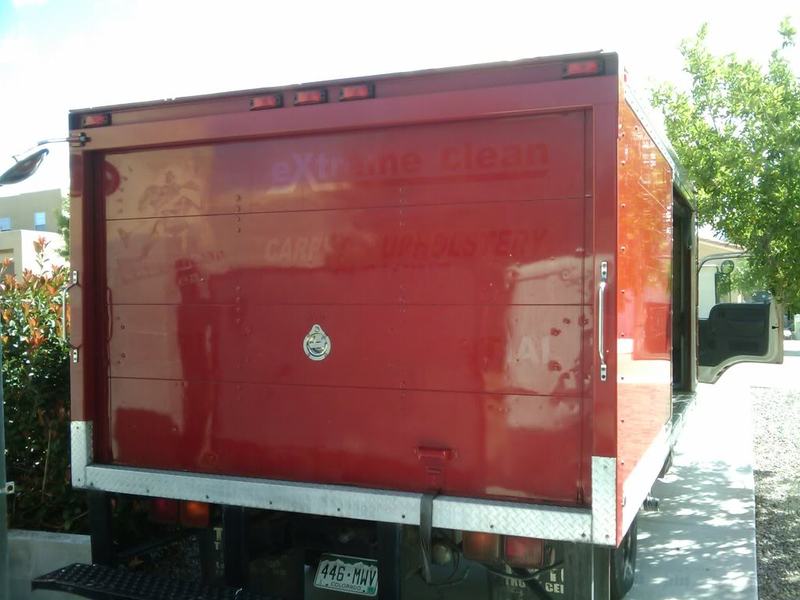

Should be easy to buff out the "Extreme Clean" lettering, or are you going to paint it?
Royal Commercial vacs are the best. What's the mop ringer for?
G
unbolt your vac hose reel and slide it bacl as far as possible and you can utilize an extra 4 x 4 space .

my only bitch would be that there's really no dedicated chem storage on the 777. Especially with the roll up doors.

Thanks for the suggestions. Storage is a hassle cuz you have to walk aroung the machine to get to the wastes space behind the hose reel. Moving the reels back is a great idea!
the mop ringer was for a laminant floor job i did last night. Forgot to pull them out this morning before snapping pics.

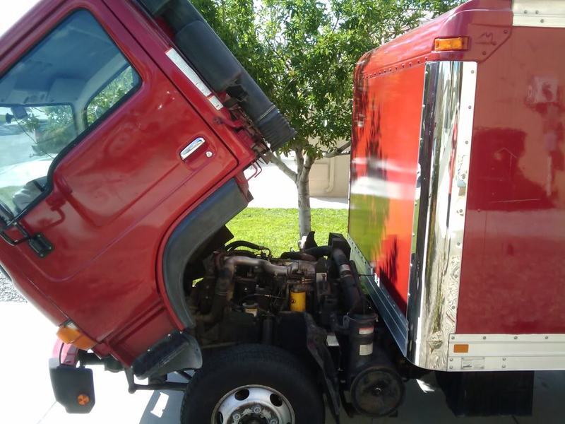

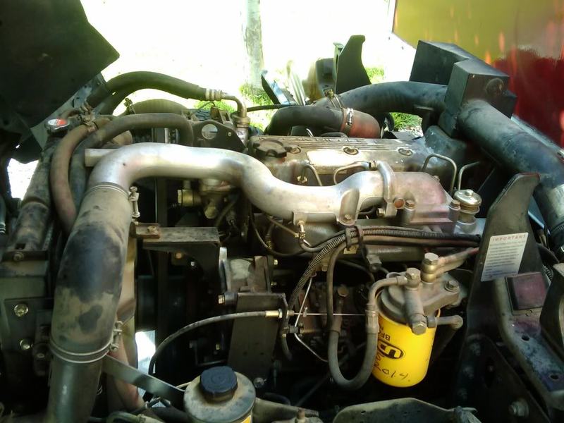

George the first chance you get do a full service on the truck.Every filter you can find on the engine. Have someone that knows tranny's check yours out. I have a unit just like yours.
My tranny went just a few weeks ago. Propably has the original though with 174,000 miles on it.
You will love the truck once you get all the bugs ironed out.
Shoot me your address in a PM, I have something to mail to you. UD Manual on disc.
These trucks where beat to death, so be sure you have the vital organs on this rig checked out.
Wouldn't hurt to change all fluids on the blower and pump.
