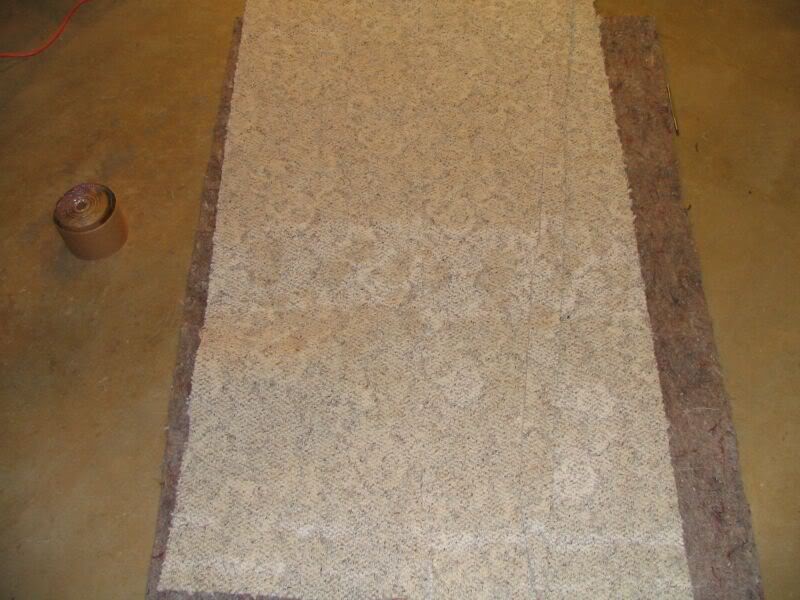

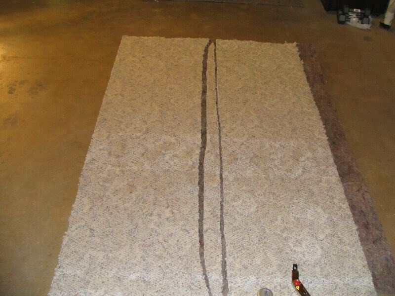

Here is a carpet with a big piece of the seam cut out and makes it very unlikely to be able to put this together

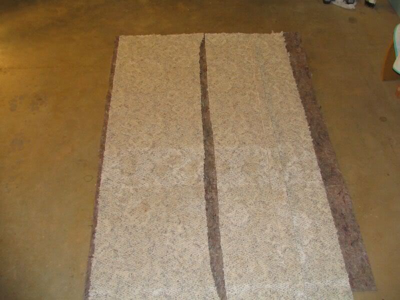

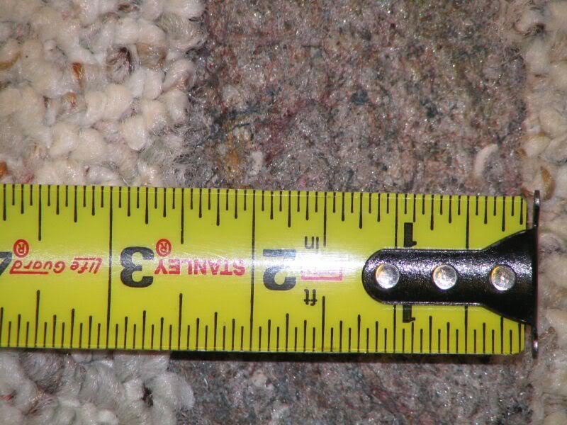

Here is what it looks like with the curve piece out of the middle, notice the ends touch but there is about a 2 and 1/2 inch cut out in this seam
here is the piece of carpet put together without squaring the edges in any way, (you can see the piece sut out laying on top)
While one would not likely put this together without trimming the egdes, it does show how extreme a condition can be worked with if one has the right tools and thinks outside the normal way of doing something. I show this to others to help them learn, if they can put this together and make a decent seam, then if they prepare the seam correctly, they should have very good results.
