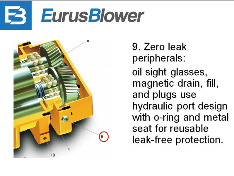

Gene I was reading up on the Eurus blowers (I know nothing about them) and came across this - it looks like the sight glass port may be set up like a hydraulic connection with an O-ring:
Reactions: Lee Stockwell

My account over at Eurus was approved. I grabbed the ZG operation manual and repair manual, I stuck 'em in the library here under Truckmount Manuals.
Gene, it looks like the sight glasses are indeed metric like you thought, and Esco has them in that thread, the only question is how best to seal them.
